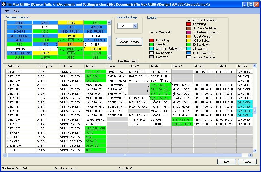

  • This pin multiplexing option is a valid IO Set.  I opened the Pin Mux Utility, selected ZCZ package, set all voltages to 3.3 volts, selected IO Set 8 for SPI1 and did not get an IO Set violation.
    Paul

  • The original signal set you requested:
    • SPI1_SCLK_MUX0
    • SPI1_D0_MUX0
    • SPI1_D1_MUX0
    • SPI1_CS0_MUX0
    • SPI1_CS1_MUX0
    is actually a valid IO Set.  The IO Set #8 is incorrect in the v2.2.1.0 version of the tool.
    The latest version (v2.3.1.0) corrects this error - it will be on ti.com soon.

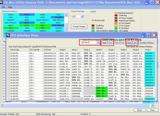

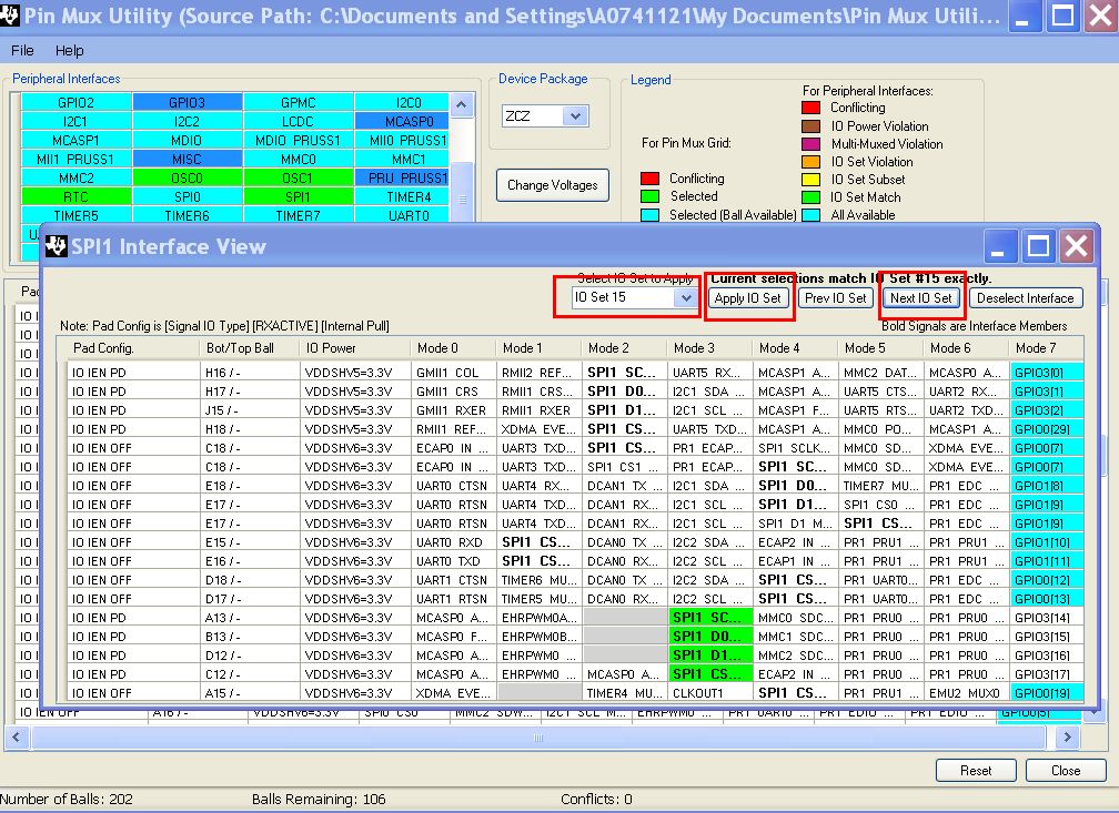

  • Hi Michael,
    What about the below SPI1 configuration? It seems to show a conflict on the peripherals list:
    Thanks in advance,
    Anthony
  • I am not sure what version of the pinmux utility the customer used on my previous post but looking at the v 2.4.1.0 this seems to be a valide IO set so I guess it is a valid config:
