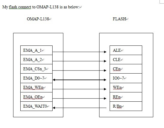

       Because there are mDDR in the OMAP-L138EVM, and DDR2 in my board, so I changed some message about DDR configuration in GEL file to suit for my board.
Now when I set breakpoint in my CCS, and run the program, but find that it can’t stop in the breakpoint, and when I right click the breakpoint and can’t set the breakpoint properties.
      and also, I find in the document I told above that it says “to use an external emulator, you need the full version of CCS, not the one that comes with the evm” and my CCS in my PC is come from the OMAP-L138EVM which silicon is 4.2.0, so I doult that whether “Nand flashing failed” is due to the incorrect CCS ? if not , why my nand flash can’t initialization?
My flash connect to OMAP-L138 is as below:
