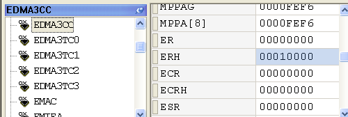

In Xilinx Chipscope, I can see that the GPIO0 works smoothly:
After that, i checked the registers in CCS and found the GPIO0 bit in ERH was set correctly.
So why the EDMA was not triggerred correctly? Can you help me to figure out the mistake in my design
