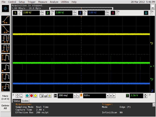

    We use FPGA write DSP in DIO mode, and it cannot nwrite persistently in the rate of 1x3.125G, 1x2.5G, and 4x1.25G. Only write well in 1x 1.25G.
    By observing the value of SP0_ERR_STAT, we think it would be physical link error. As you say, it may be link misalignment, unexpected symbols received, etc. But what I want to know is the real reason of these errors. Are there any electrical requirments that not satisfied ? What should I do to adjust the register of C6678 or FPGA to achieve good performance?
  • FPGA nwrites C6678 at 1x1.25G, and could send sustained data successfully.
    But in 4x1.25G mode, FPGA nwrite C6678 dozens of packets, then stop for about 430ms, then continue transfer dozens of packets and stop for 430ms, again and again. The wave form captured by oscilloscope as follows:
