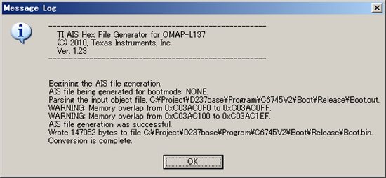

Hi Champ,
I tried to convert ELF into a boot image for C6745 by AISgen(D800K003 v0.7.0.0), and got a error message.
I attached the error message box below.
So, could you please diagnose the error message?
And I'd like to know whether the AISgen(D800K003 v0.7.0.0) support  ELF input or not.
Thanks in advance for your cooperation.

  • Hi Mukul-san,
    I'd like to ask you a favor again.
    It's about AISgen warning messages below, mentioned in my first post.
      WARNING: Memory overlap from 0xC03AC0F0 to 0xC03AC0FF
      WARNING: Memory overlap from 0xC03AC100 to 0xC03AC1EF
    If you have any, could you please let me know why  the warning messages are indicated?
    Thanks in advance for your support.
    j-breeze
  • Hi j-breeze,
    Can you see from the map file of your Boot.out file what section is being loaded in the region 0XC03ACOFF and 0XC03AC1EF.  Did you see any warnings from the linker when you built the out file? Are you passing 2 input files to the AISGen tool?  If yes, can you confirm that there is no overlap in the linker sections in the DSP UBL and the application code.

  • Hi Rahul,
    Thank you for your advice.
    I checked out  the map file and the sections below was being loaded in the region 0xC00CA528 and 0xC00CA53F.
    (The region was changed due to program updated.)
      .text.1    0    c00881a0    000423a0
                        c00ca480    00000038     c674xfastMath_elf.lib : exp2sp.obj (.text:hand)
                        c00ca4b8    00000038                           : expsp.obj (.text:hand)
                        c00ca4f0    00000038                           : log10sp.obj (.text:hand)
                        c00ca528    00000018     --HOLE-- [fill = 0]
      .const.2   0    c00ca528    00000008
                        c00ca528    00000008     ParameterEdit.obj (.const:.string)
      .text.2    0    c00ca530    00000010
                        c00ca530    00000010     Standby.obj ($Tramp$S$$EnterStandby)
    "const.2" and "text.2" were overlaped with "--HOLE--" of "text.1".
    The linker v7.3.4 divided the sections automatically and  didn't generate any warnings.
    I don't know why the overlaps occur.
    So, could you please let me know the causes?
    Are there anything else what should I check out?
    j-breeze
  • Hi J-breeze,
    I don`t have complete understanding of how the linker works in this case but could you specify how you have specified the sections in the linker command file and if there is any flag that you have turned on in the linker that is suppressing any warnings. Do you have -v option with your linker perhaps that should give you a complete dump of the linker output.
    I would also try the following in the linker command
    .const:
      " ${PATH_TO_OBJFILES}/ParameterEdit.obj"(.const.2)
     .text:
      " ${PATH_TO_OBJFILES}/Standby.obj"(.text.2)
    PATH_TOOBJFILES is the path to the folder that contains the obj file Standby.obj and ParameterEdit.obj.
    This instructs the linker to place the split sections(.text.2 and .const.2) in the same place as the rest of the .text and .const section. If this doesn`t work I would have to consult an compiler expert to see how to resolve this issue. By the way did you try to boot the resulting AIS image (ignoring the warning), that might tell us how critical those warnings are.
    Rahul
  • Hi Rahul,
    Thank you for your suggestion.
    I'll try the linker command soon, that you showed me.
    And, the AIS image ignoring the warning works well so far because the sections are overlaped with the "HOLE" area, I guess.
    So, those overlap warnings might not be critical.
    However, I'd like to clarify the root causes and how to resolve this issue.
    The overlaps might be "bug" in the linker v7, according to a forum below.
      o Fetch packet exception thrown from trampolined functions
         (http://e2e.ti.com/support/dsp/c6000_multi-core_dsps/f/639/p/164715/609248.aspx)
    Could you please refer to the forum,   especially last 2~3 posts in the forum.
    j-breeze

  • Hi Rahul,
    I was be able to found that the overlap was a bug in the linker v7 and confirmed that v7.3.6 or later solves it.
      o C6000 C/C++ CODE GENERATION TOOLS v7.3.7 Defect History
        <INSTALL_DIR>\C6000 Code Generation Tools 7.3.7\DefectHistory.txt
        - Line 161~174
          FIXED  SDSCM00042408
          Summary            : Linker creates overlapping sections
                               when section allocation is done using
                               ">>" operator
          Fixed in           : 7.3.6
          Severity           : S2 - Major
          Affected Component : Linker
          Description:
          Linker may create overlapping sections when section
          allocation is done using ">>" operator
    I really appreciate all your support.
