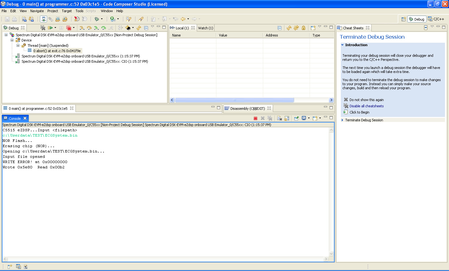

Facing Problem in installing the software in Flash. The application only runs when the Debugger is used. It does not run in Standalone Mode
  • Hi C5000 Team,
    The setup is C5515 based MDK with ECG frontend.
    The issue is that the flashed code is not saved on power up. Is there a flash inside that can be used for standalone operation? Or are we missing some steps.
    Can somebody please help?
    Best Regards
    Feroz

  • It tried it but the application do no. The output of the programer application is:

  • C5515 eZDSP...Input <filepath>
    c:\Userdata\TEST\ECGSystem.bin
    NOR Flash...
    Erasing chip (NOR)...
    Opening c:\Userdata\TEST\ECGSystem.bin...
    Input file opened
    WRITE ERROR! at 0x00000000
    Wrote 0x5e80  Read 0x00b2
    NOR Flash...
    Input file opened
  • Hello Mr. Aseem,
    is this issue resolved. If yes, please verify close this item.
    Else, please share the snapshot - upload it here.
    Best Regards
    Feroz
  • No the problem has not been solved.
