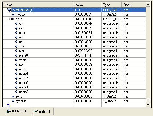

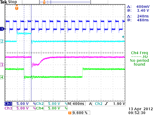

we are developing SW for a new product using the C6746 and noticed the following strange effect when using the McBSP.
We use the McBSP to interface to a 4Mbit/s PCM highway (64 timeslots, 8bit/slot). Clocks and framesync are generated externally. We use Transmit Multichannel Selection Mode = 3 and Receive multichannel selection mode = 1.
If timeslot 0 is selected in RCER and not selected in XCER, the first bit after the end of the framesync is driven low (or hi depending on the data written to DXR for that timeslot) by the McBSP instead of staying Hi-Z.
Any ideas what's causing this? See screenshots of the signals and the McBSP settings below.
