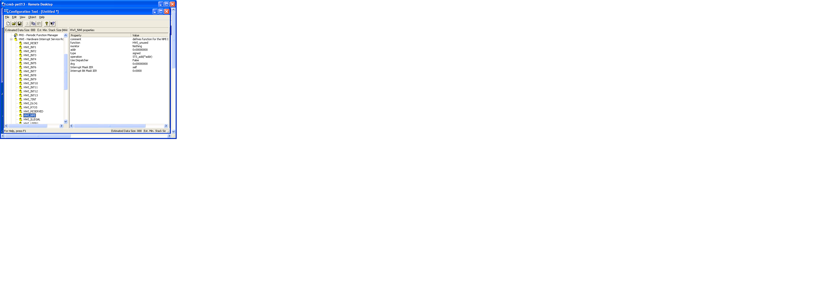

  • Hi tony chen,
    You can use the BIOS configuration tool to handle an NMI interrupt.
    For example, if I open a C28x based BIOS configuration file (*.tcf file), I see this under the HWI manager:
    You can configure the "function" property so that it will run a particular function when triggered.  Similar for ILLEGAL.
    Please also see this document for some more information:
    http://www.ti.com/lit/ug/spru430e/spru430e.pdf
    Steve

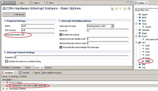

  • Hi Steve,
    I am using SysBios 6.32.05.54 with CCS5.1, in the CCS5.1, all the BIOS hwi needs to be added by assigning the interrupt number to a function manually.
    When I created a new hwi with the int number 18 (NMI for 28335), the following picture showed.
  • Hi Tony,
    Can you try adding the following into the code of your *.cfg file?  You will need to replace "<your ISR function>" with the name of the ISR function that you want to run when the NMI is triggered.
    var Hwi = xdc.useModule('ti.sysbios.family.c28.Hwi');
    Hwi.plugMeta(18, <your ISR function>);
    Steve
  • Hi Steve,
    Thanks, it works.
    By using asm(" INTR NMI"); I was able to trigger my NMI ISR.
    But I didnt find any GUI interface showing the NMI and ILLEAGLE interrupt status in CCS 5 yet.
    B&R
    tony
