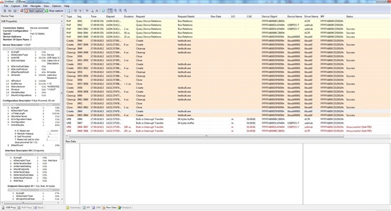

  • I am using USBlyzer USB analyzer software in order to trace the transactions between host and device. According to the output, firmware sends STALL packet when IN transaction request has came.The endpoint should send data in response to IN token packets instead of stalling. Indeed, there is not any stall routine for EP1 in my code as seen above code. Thanks in advance for any help..
    Best...
    Yusuf
