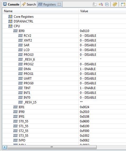

    3. There is a very valuable tool in CCS that lets you look at the actual status of each register in the C5515. You can look directly at the status of INT1 to see if your AD1298 is actually bringing the interrupt line low. If you haven't yet discovered this tool (view) you should find it and use it. Here's a snapshot.
    As you can see, INT1 is in IER0.
    I haven't used the external interrupts yet, but I assume they need to be set for positive or negative transition triggering. It not, they may be positive trigger only. You should check this out also.
