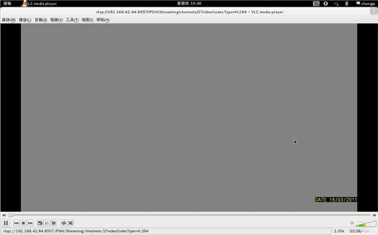

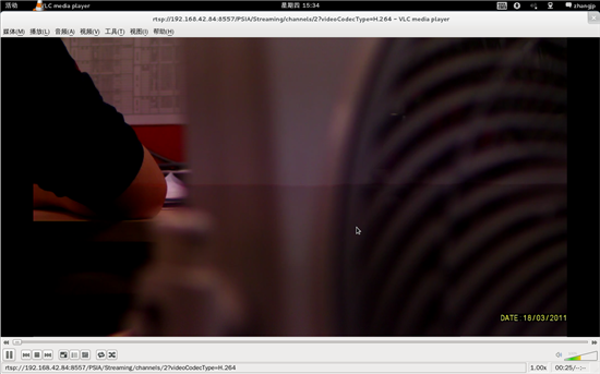

Q2:
When set IPIPE_YEE_EN[0] to 0, the camera can not output normal h.264.
Modify the iss_02_00_00_00/packages/ti/psp/iss/hal/iss/isp/ipipe/src/ipipc.c-->ipipe_config_edge_enhancement
function as follows:
ISP_RETURN ipipe_config_edge_enhancement(ipipe_ee_cfg_t * cfg)
ISP_WRITE32(ipipe_reg->YEE_EN, 0);
return ISP_SUCCESS;
The video Image flicker,The camera output H.264 as follows:
or
Anybody have good idea? or give us some advice?

    About Q2,
    If modified the Iss_capt2AUpdate() function as follows:
    Int32 Iss_capt2AUpdate(Iss_CaptObj * pObj)
        //ipipe_config_edge_enhancement(&edge_enhance_iss_appro_params);
    And 2A Engine(web->Settings->Camera) is APPRO,2A Mode (web->Settings->Camera)is Auto Exposure+Auto White Balance.
    The result is the same as above:The video Image flicker.
    Do not known why.
