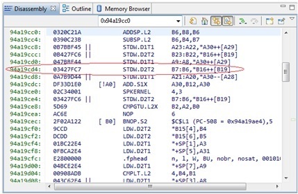

  • Not that I'm offering solution, but I wonder if you can confirm following. Provided your map file and disassembler output for DSPF_sp_fftSPxSP.obj from dsplib674x_elf.lib failing instruction is STDW.D2T2 B7:B6,*B16++[B19], two lines above SPKERNEL 0,11. Can you confirm that this is indeed the case? To do that 'dis6x your_binary.out > file.txt', open file.txt in text editor and locate 95269954, the failing address. Is it above mentioned STDW instruction in vicinity of above mentioned SPKERNEL?
    For reference, DSPF_sp_fftSPxSP appears/is interruptible, but it has lesser to do with SPLOOP, in sense that one can program SPLOOP in such way that it would require disabled interrupts to operate correctly. Nor does interrupting SPLOOP work by saving loop buffer content on stack, but it's of lesser relevance...
  • Because I compile a new version of my project, the exception address moved "a bit" but is consistent.

    NRP=0x94a19cd4 address point to the same instruction into the ASM routine.
  • Uhm... All instructions appear identical except for one, SPKERNEL. My copy of DSPLIB 1.03 has SPKERNEL 0,11, while you show 4,3... I've even checked most recent version 3.1, it's same code there, same source, same binary. For corresponding SPLOOP instruction found in my copy 4,3 would actually be inappropriate/invalid value. What's your SPLOOP? Slide up in disassembly till you see SPLOOP, it should be at 0x94a19b0c. I have SPLOOPD 14, what do you see?
    Anyway, if we assume that your disassembler simply renders SPKERNEL instruction wrong (for whatever reason), it's very strange place to suffer from resource conflict. ILC value suggests that the loop actually executed a fair number of iterations, meaning that it generally works. IRP value suggests that loop was interrupted earlier, but recovering from interrupt is equivalent to initial stage, which is also generally works, since loop did start at least once and progressed to given ILC...

    As implied it's not impossible that disassembler simply displayed it incorrectly. Basically in order to disassemble SPKERNEL correctly one has to look at corresponding SPLOOP parameter. If disassembler didn't care to look back "far enough" it could have assumed some most common parameter and as result displayed SPKERNEL parameters incorrectly. I just had second closer look and it's the same encoded instruction as I have,  0x02C34001. So that 4,3 vs 0,11 must be simply disassembler glitch, nothing to worry about. Sorry about confusion.
