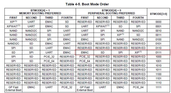

We want to boot DM6168 from SD card preferred, then NOR flash, so we set the BTM[4:0] to b'00111 on EVM, and it failed to boot from SD card.
Is there something omitted?

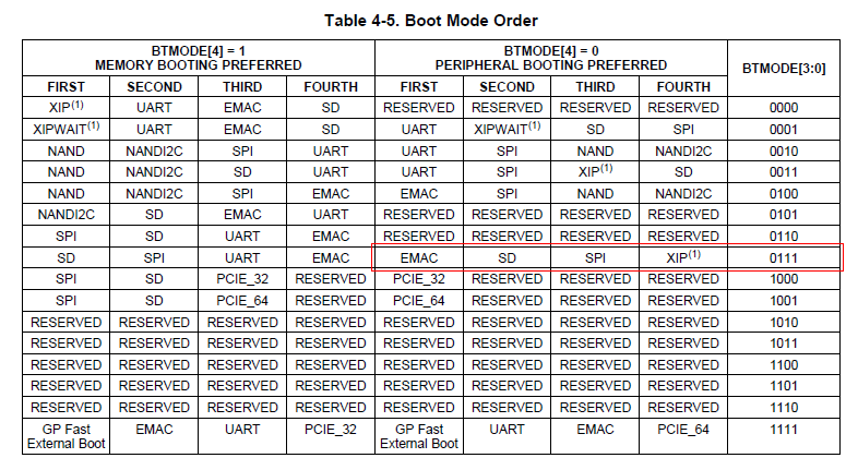

Hi AnilKumar,
Yes, I know the EVM switch settings, let me explain it detailedly.
Now I want to boot from SD card if SD card is available, if it is not available, I want to boot from XIP device (NOR flash), so I set the boot mode switch BTM[4:0] to b'00111, following the section 4.3 Boot Sequence, SPRS614A. But it boot failed even I insert a boot SD card (this SD card can boot properly when I set the BTM[4:0] to b'10111).
Jed
Hi AnilKumar,
The U-Boot guide just shows that the case of first priority boot device is NOR/NAND/SD card, but I want to boot from different device with specified priority, such as SD card firstly, if it is failed, then boot from XIP device.
Jed ZHU
