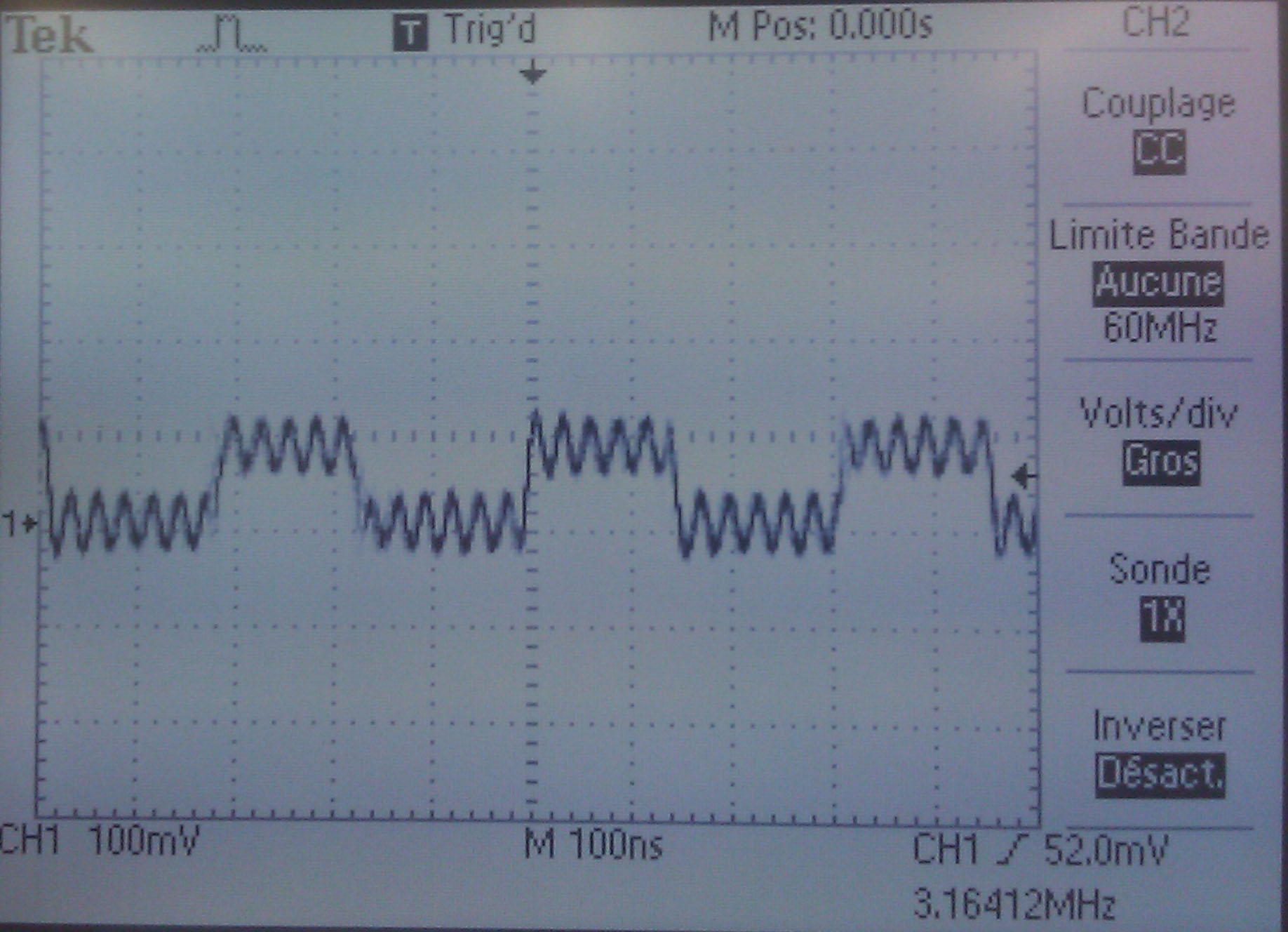

I’m currently starting to debug a custom board, with 3 TMS320C5502 (clock at 27Mhz) on it. Those 3 DSP has their GPIO connected together (so each GPIOx connected together). Apparently (still trying to figure out exactly how to program the 3 DSP), only one processor is running while the two others are in reset. So only one processor is trying to put value on the GPIO port.
So right now, I can load some program on one DSP, and I made some test. The first test I’m trying to do is to make a led blink:
void testLed(void)
	    //Initialize GPIO handler
	    GPIO_Handle hGPIO;
	    hGPIO = GPIO_open(GPIO_GPIO_PIN6 | GPIO_GPIO_PIN4, 0);	//Undefined flag
	    GPIO_pinDirection(hGPIO, GPIO_GPIO_PIN4, GPIO_GPIO_PIN4_OUTPUT);
	    GPIO_pinEnable(hGPIO, GPIO_GPIO_PIN4);
	    while(TRUE)
			//Set GPIO4
			GPIO_pinWrite(hGPIO, GPIO_GPIO_PIN4, 1);
			GPIO_pinWrite(hGPIO, GPIO_GPIO_PIN4, 0);
Now, I’ve got a very strange signal on the scope:
And after a while, It looks like the DSP stop working: I see the power consumption going from 240mA to around 100mA for the whole board (on the 1.26V). For code composer, the code is still running, untill I hit “pause”, and get:
