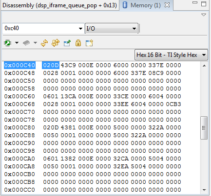

To debug this, I added logging to the interrupt handler to take note of the current source address (i.e. contents of DMACSAC) at the time of the interrupt; it should obviously be either the first element (array[0]) or the first element of the second half (array[20]). It is not. It is always alternating between array[16] and array[36]. This suggests some kind of offset, but by logging every change to the DMACSAC register I can see that the only addresses it ever shows are from array[16] and array[39].
I've attached here a snapshot of the DMA registers just after set-up. DMA channels 2 (base 0xc40) & 4 (base 0xc80) are receive channels, and it can be seen that the destination address start and DMACDAC are the same at this time (0xc46 & 0xc4d, and 0xc86 & 0xc8d) . Channels 3 & 5 are transmit channels and the source address start and DMACSAC values are different, even after initialisation. As said, those starting values (0xc6c & 0xcac) never go below these values, or match the start address (0xc64 & 0xca4).
I've tried the same logging of the DMACDAC registers on the receive channels at frame/half-frame interrupts and they behave exactly as expected - always either array[0] or array[20].
