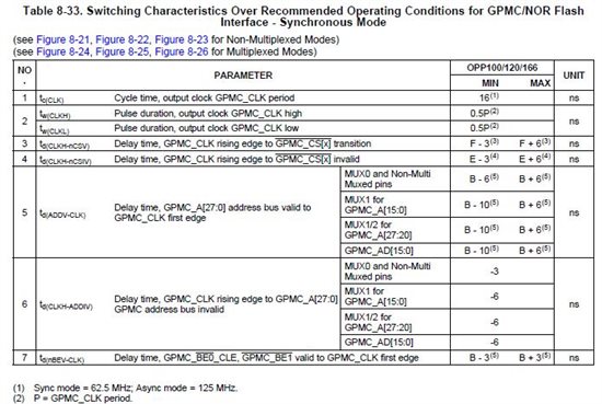

Before, I asked " (1) Sync mode = 62.5MHz, Async mode=125MHz " in the note of Table 8-33 (page 241,datasheet sprs695a).
And I got some information from E2E that the correct is "sync mode=50MHz, Async mode=100MHz" and this frequency represents GPMC_FCLK.
However I am still confused.
According to TRM, it is written that GPMC_CLK is kept low when access is defined as asynchoronous.
Why async mode =100MHz is defined as the above? And why sync mode is the half frequency of async mode?
I must explain to customer the right meaning of this sentence.
Please give me some advice.

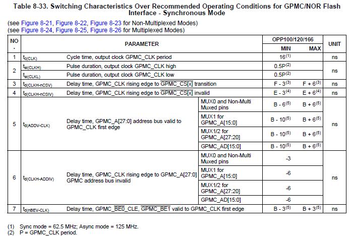

    I posted the datasheet(P241)' snapshot the following.
  • Chaitanya-san,
    Sorry for my mistake. I failed posting.
    I try again it.
    Please see the following.
    And, The link is the following.
    http://e2e.ti.com/support/dsp/davinci_digital_media_processors/f/716/p/183641/663907.aspx#663907
    Please verify it.
    Michi
  • Michi,
    This table by itself is not giving much information, but I understand that this table seems to be referring to a "Timing diagram" elsewhere.
    In such a case, my guess is correct.
    >>This is neither specifically GPMC_FCLK nor GPMC_CLK. The frequency being talked here is the frequency of the clock using which the memory control signals are asserted/de-asserted.
    >> All the time GPMC works at GPMC_FCLK = 100MHz
    >> Asynchronous mode: All the Assert/de-assert are done with reference to  GPMC_FCLK = 100MHZ
    >> Synchronous mode:  All assertions/de-assertions are done with reference to GPMC_CLK = 100MHZ / ( 1+ GPMCFCLKDIVIDER)
    >>               Normally in Synchronous mode GPMCFCLKDIVIDER = 0x1 ( GPMC_CLK = GPMC_FCLK/2 = 100MHz/2 = 50 Mhz)
    Chaitanya
