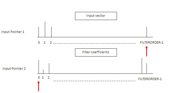

We have a sample code which is written in assembly.
The instructions for C5515 are
_Test:
AC0 = 0;
repeat (#351)
AC0 = AC0 + ((*AR0-)* (*AR1+));
(*AR2+) = HI(AC0);
(*AR2) = AC0;
return
The Test routine takes three int16 pointers. The first two are inputs and the third one is output.
What will be the equivalent instructions to convert it to C6727B?
If I understood correctly for C6727B the first two arguments are passed in A4, B4 respectively and the third argument is passed in A6.
What about the equivalent instruction for repeat in C6727B?

    I know the code that you are referring to in this case. One key detail that you are missing in your post is the first input pointer is initialized to the last sample in the buffer while the second input pointer is initialized to the first sample in its input buffer. That makes this code equivalent of computing one sample of filtered output using simple convolution of input samples with filter co-efficients. Refer to the diagram below
     I am pretty sure there is equivalent assembly or intrinsic C code for convolution function in C67x DSPLIB found here
    http://www.ti.com/tool/sprc265 (The code however would be for floating point function )
    If that doesn`t work, here is the Equivalent pseudo code
    int32 acc;
    for (i=0; i<FILTERORDER; i++)
     acc=acc+ x1[FILTERORDER-i-1]*x2[i]
    y[1] = (int16) (( acc & 0xFFFF0000)>>16) //Extract top 16 bits
    y[0] = (int16) (acc & 0x0000FFFF)  //Extract bottom 16 bits
    where x1 and x2 are input and y is the output.
    Try that out and let me know. Good luck!!
