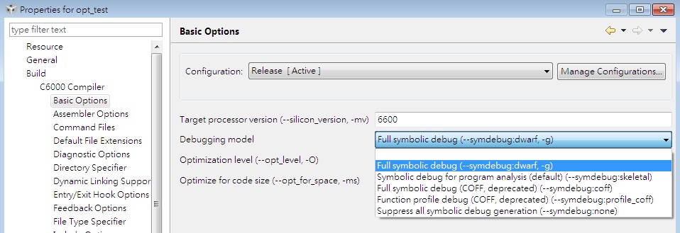

  • Dear all,
      I have read sprabf2 Introduction to TMS320C6000 DSP Optimization
      I don't know how to see the details like "Unroll Factor"  "Loop Carried Dependency Bound"   and aslo the details in ex.9
      And I have tried some examples  (ex.15)
      There are two problems  I encountered.
      First, the CPU cycle count doesn't match the value in the document.
      It's about 2 to 3 times of the value in the document.
      The cycle count is measured by CCS5. (Run->Clock->Enable   and  set breakpoint )
      Second, the function dotp2 doesn't decrease the cycle count.
      What's wrong with my project ?   It's weird.

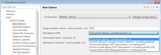

  • Thanks for your help
    Clement,
      I doesn't understand " use O3 with no debug"  which also reference in the document.
      Which one should I select ?

  • Select first line, which is blank, right above 'Full symbolic debug'. From this perspective, debug configuration is to specify -g option, while release is to specify none.
  • Thank you
    I have chosen the blank line but.....
  • If the blank one doesn't work, use the last one.

    If you remove the symbolic debug info, the debugger is not longer able to show you the associated source code. This is normal. You should left the default symbols generation option but for the optimized compilaiton unit. You cannot step in the optimized code, but you can step in the non optimized (for instance, the main routine tht calls your optimized routine). Note that  the optimization options cab ne tuned on a file-by-file basis and also on a directory-by-directory basis.
    Make a directory for your optimized code, place under that directory all the file you want to optimized and then play with optimization option only on that direcotry, leaving the main unoptimized.
    Anyway, it is not necessary to disable the debug symbols generaiton, You can set the option "Optimize fully in presence of debug directive" in the "Runtime Model Options" panel. Again, applay it only to source file/directory to be optimized.
