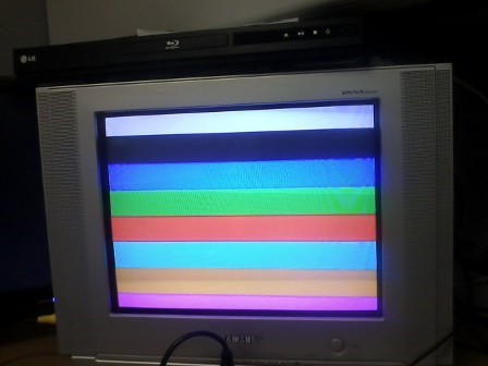

    Here's a rundown of what I see...it looks like I'm having some issues similar to those that you described in your first two posts...
    • As far as I can tell on my non-widescreen TV, the luma looks correct.
    • I think it is scaled OK...but again, my TV can only really show < 640 of the 720 width.
    • I do not see the chroma data, despite having set /sys/devices/platform/vpss/display2/output to "composite"
    • I see a lot of noise (red, green, and blue...pretty sure this is not my chroma data though)
    Perhaps someone from TI might be able to give us a few clues on this.

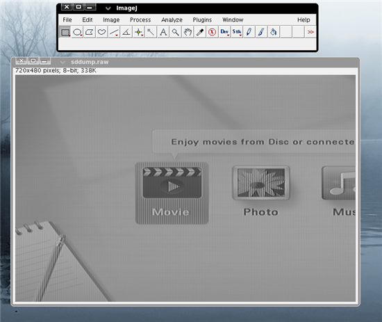

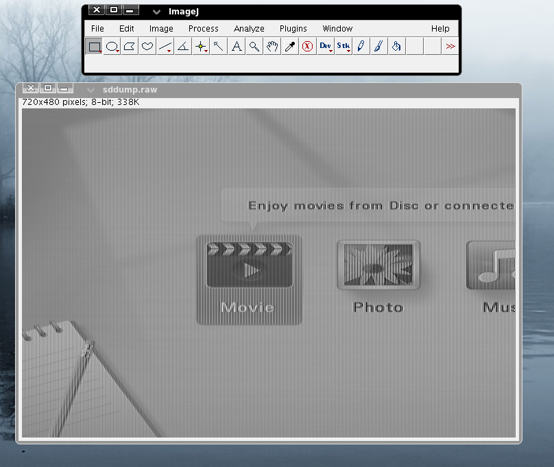

    [UPDATE]  So I was able to get access to a widescreen TV with S-Video input, so I tested Siva's code with this setup as well.  I seem to only get half the width of the scaled image, and it looks like there's vertical lines of some other data.  Does this sound like an output format issue to anyone else?  Has anyone else gotten YUV420SP out of the first DEI output successfully?
    I guess a good next step would be to save off a frame coming out of the DEI or into the SD display and inspect it offline to double check whether it's actually YUV420SP.
    Siva -- if you get around to saving off one of those frames before I do later this week, would you mind posting it here (with the height and width noted).

  • Hi Siva / Jon,
    DEI supports 420Sp output. In the capture-encode example, DEI output which is fed to encoder is 420SP. Encoder can take only 420SP (NV12) input in EZSDK. Please check, If you see encoder o/p proper ? If yes, It is correct 420Sp o/p. Also in above posts it is not clear -
     Anyone of you have got SD display  (without capture or DEI) example working properly ?
    Vimal
  • Vimal,
    Please see my reponses to the two items you mentioned. I've tried to provide all the files and detail needed to recreate the issues.
    ===== DEI 420SP Output Issue ====
    I have attached my modifications to Siva's capture encode demo SD-display changes.  The attached code is in the following configuration:
    DEI Output 0 (downscaling) --YUV420SP--> SD Display (Does not work, DEI appears to output YUV422 despite our configuration)
    DEI Output 1 (no scaling) --YUV420SP--> Encoder (Looks good)
    Also attached are a raw frame from DEI Output 0, and the video encoded using DEI Output 1.
    The issue we are seeing is that in this configuration, DEI Output 0 appears to still be outputting YUV422, despite configuration as YUV420SP.  The attached code dumps frames going to the SD display; I attempted to import the luma as a 8-bit raw image in ImageJ: as you see in the below screenshot, it looks like alternating pixels have are chroma data, and we only get 1/2 our image width -- to me this looks like we're getting YUV422 data instead of YUV420SP, as we've configured it.
    In short, I'm convinced that there's either a bug in the modifications to the Capture-Encode demo (which neither Siva or I have spotted yet), or DEI Output 0 fails to output YUV420SP. (But yes, I do see that DEI Output 1 works fine with YUV420SP.) Can you take a look at the attached code and see if it works for you?
    ===== SD Display Demo =====
    I have not seen good output from the SD Display demo -- with my test patterns, the color data doesn't appear to get used, and it looks like some chroma is being used as luma data. I see the checkerboard pattern, but it flickers with some garbage color, and the luma checkerboard becomes green/magenta (indicating that it's being used as chroma.)
    Could you provide a couple frames of the test data that you know to work? I have attached some quick and dirty code that I used to generate YUV420SP checkboard patterns, with chroma values incrementing by 1 each frame.  Perhaps you or Siva could try this out and let me know what you see?
    Jon
    Attachments (Remove .txt extension...forum appears to restrict files based on file extension...)
    2541.capture_encode.sd-only.tar.gz  My modifications to Siva's modified code. It's hardcoded for SD display, so the command line args are mosty dummies (e.g. display select) I run this as follows, with a 720p input source: ./bin/capture_encode_a8host_debug.xv5T -f 60 -m 720p -b 1000000 -o test1.h264 -n 1000 -d 0
    2548.sddump.bin.txt  Raw data frame (720x480) from DEI Output 0, which I would have expected to be YUV420SP, but it looks like YUV422 (or just corrupted) to me...
    4314.test1.h264.txt  H.264 output from encoder (DEI Output 1). This looks good and shows the 720p video what we should be seeing in the above screenshot (of course, scaled down).
    1778.testpattern-420sp.tar.gz  Some code to generate test YUV420SP test patterns.  To generate 500 frames of 720x480 run as follows: ./testpattern 720 480 500 pattern.bin
  • Jon,
    DEI dual out component can provide ONLY one o/p as 420SP. It is as per hw paths. It can provide though both 422 o/p. I could not make out from earlier posts that you have been trying 420 outputs on both ports. apology for inconvenience..
    For SD display, do you see Luma component fine ? We have observed color issues for SD display in few DM8148 EVM. Encoder input samples should be fine for SD display.
    Vimal

  • Hi Vimal ,
    I don't think it will be the EVM issue . I have integrated the v4l2 code into the OMX Capture_Encode application and displayed the frames on Display2 (SD Display ) .
    I can see the display (720 x 480) clearly using v4l2 code  . I think its a problem with the OMX framework . Please attach the YUV420SP sample files that you have used for testing SD display successfully .
    Also it will be better if you can let us know ,how you have tested out SD display on DM8148 EVM using EZSDK 5.04 .Is PAL mode is supported in current EZSDK ?
    @Jon ,
    Hi Jon,
    I have generated the YUV420SP color patterns with your source code  . when I tried to display the patterns using OMX display example , I observe the same . colors are improper . Have you tried any other option ?
    N Sivaramkrishna .

  • Hi Siva & Jon,
    As i figured out EVM issue would cause color issue for composite Vs SD display mode, (EVM could not be configured for composite mode earlier). However, as one of you also pointed in earlier post, making display explicit composite would show the colors as well.
    I also tried to reproduce the issue, after few iteration I could see the issue of colors jumping. similar observation as you had, chroma looking like assuming role of Luma. And sometime it is proper as well !
    For generating NV12, I used decode example and modify file write function to create required o/p. H264 streams can be used to generate this.
    We are looking at this issue, since I could observer the display sometimes proper as well, It does not seem to be setting issue. I will keep you posted.
    Vimal
    It appears that file read is causing the sd display colors issue. I removed the file read post initial frames fill (same frames repeated after that), and do not see luma/chroma  mixing issue. It appears that not getting the frames in time due to file read delay causes this. Could you try the same and let me know the outcome.

    I tried it multiple times. I even tried with color bar pattern and do not see issue. Please see below code for generating color bar.
    static unsigned long cbcr[8] = {
    0x80808080,
    0x80808080,
    0x5af05af0,
    0x36223622,
    0xf06ef06e,
    0x10921092,
    0xa610a610,
    0xcadecade
    static unsigned long yy[8] = {
    0xebebebeb,
    0x1e1e1e1e,
    0x51515151,
    0x91919191,
    0x29292929,
    0xd2d2d2d2,
    0xaaaaaaaa,
    0x6a6a6a6a
    void color_bar(char *addr, int width, int height)
    unsigned long *ptr = (unsigned long *)addr;
    int i, j, k;
    for(i = 0 ; i < 8 ; i++) {
    for(j = 0 ; j < (height/8) ; j++) {
    for(k = 0 ; k < (width >> 2) ; k++) {
    ptr[k] = yy[i];
    ptr = ptr + (width >> 2);
    for(j = 0 ; j < (height/16) ; j++) {
    ptr[k] = cbcr[i];
    You can put this function in Filldata function as
    frameSize = (SD_WIDTH * SD_HEIGHT * 3) >> 1;
    color_bar(pBuf->pBuffer, SD_WIDTH, SD_HEIGHT);
    dataRead = frameSize; //fread (pBuf->pBuffer, frameSize, 1, pAppData->fIn);
    Please try above and let me know, if you still see the issue.
    Vimal
  • Vimal,
    Thank you for providing this sample - I do not see the issue with the provided color bars! Attached is a picture of what I'm seeing on my display, for your verification. (Note that all the bars are a solid color...there's just some glare off the TV.)
    To further verify your suspicion of the issue being timing related, I added a 150 ms delay (might be a tad overkill...) to the fill data call -- this reintroduced what appeared to be the same issue.
    (1) So is there a minimum rate at which I need to ensure I deliver data to the SD display component via my OMX code, or will this be dealt with from the M3 firmware side of things?
    (2) Are you at liberty to say when a set of SD-related fixes (M3 firmware binaries or A8 OMX patches) will be released? I know you mentioned there being a number of known issues which the various TI teams have already resolved. Even just a rough estimate will do (a couple weeks, 1 or 2 months, or > 4 months?) -- my team needs me to provide some risk analysis with respect to whether or not we'll meet our SD display functionality on time...anything you can let us know would help greatly! :)
    Thank you so much for your time and help Vimal -- we really appreciate it!
    Jon

  • I just had the opportunity to drive a higher definition display with the SD (composite) output, using Vimal's modifications to the display demo.  I got to get a better look at the output.
    I'm seeing that the chroma and luma seem to be a bit off where one color bar meets another.  Is this just typical by nature of the SD video's fields or is this a possible issue/bug? Siva or Vimal, do you see this?
    Thank you,
    Jon
