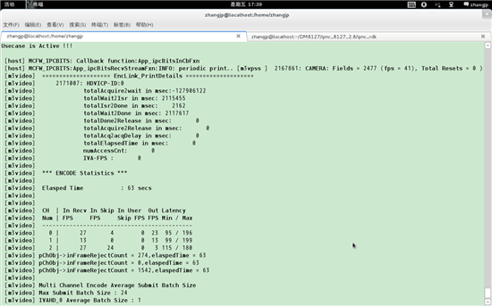

DM8127 run ipnc2.8 program and in the LOW POWER USECASE .
The camera output H.264(5M)+D1+MJPEG(5M),but the mjpeg encode rate is only 1 FPS,
the output encode Statistics are as follow :
The In User Skip FPS is 10.
I modify the EncLink_doSkipFrame() function (ipnc_mcfw/mcfw/src_bios6/links_m3video/iva_enc/encLink_common.c) .
The modified codes are as follows:
Bool  EncLink_doSkipFrame(EncLink_ChObj *pChObj, Int32 chId)
    if (pChObj->frameStatus.inCnt > pChObj->frameStatus.outCnt)
        pChObj->frameStatus.outCnt +=
        (pChObj->algObj.algDynamicParams.targetFrameRate/1000);
        /*skip this frame, return true*/
         return TRUE;
modify to
         //return TRUE;   //not run

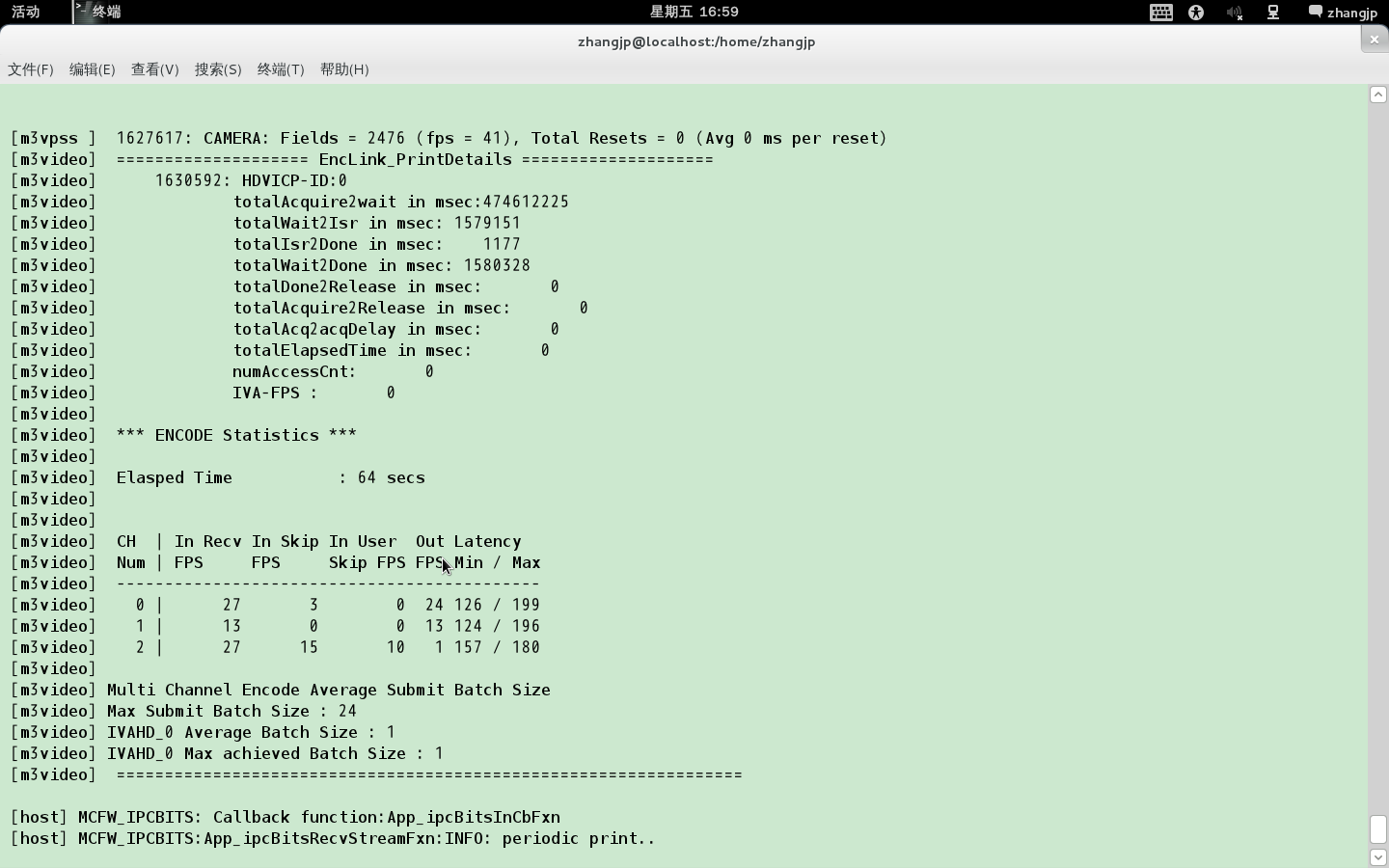

Now the In User Skip FPS is 0, but the output rate is only 3 FPS.
the output encode Statistics are as follows:
The In Skip PFS is 24 FPS. How can I reduce this Skip PFS and lead output rate more than 3 FPS?
Thanks!
  • Hi Gomo.
    I am trying this in fullfuture mode 1080P,  i'm not sure if it also works the same in lowpower 5MP.
      static int iCounter1;
      iCounter1++;
      if(chId==2) {     return FALSE; }
      if(chId==0) {     if (iCounter1 % 10)        return TRUE;     else        return FALSE;  }
      if(chId==1) {     if (iCounter1 % 4)        return TRUE;     else        return FALSE;  }
     and i am getting this:
    Regards.

  • Hi Gomo,
    can you tell me what is your target frame rate for MJPEG 5M, and also for H264 5M and D1?
    Looks like MJPEG encoder is skipping frames because of the performance constraint on HDVICP, by default H264 encoder should have a higher priority than MJPEG.
    The changes proposed by other friends in this thread actually limits the H264 output frame rate and thus give more performance to the CH2 emcoding (MJPEG), but this may be not what you want.

  • Well, Actually there's no priority setting on the encoder, however, all streams (H264 main, H264 secondary, MJPEG) share the same process queue and when the process queue is getting full (it means the hardware encoder doesn't have enough time to encode all input frames), frames are going to be rejectted. By default, we assign the channel ID 0 to H264 main, 1 to H264 secondary and 2 to MJPEG, and every time we receive a multiplexed stream, input frames are taken through the channel ID order, so you understand why MJPEG is the most unlucky one.
    Now, the obvious way to modify this is chaging the channel ID in the multiplexed stream (for this you just need to modify the merge link input). Otherwise you can try the method proposed y Marko to have a more flexible control.
    The IVAHD is designed to support 1080P60 encoding, that means 120M pixel per second, in our triple streams use case we have realized 1080P60 + D1/30 + MJPEG/5 = 140M pixel per second. But 5M MJPEG + 5M H264 + D1 264 all at 15fps = 155M pixel per second, without counting any eventual penalty for the high resolution. If you really need this you may use the SIMCOP based MJEPG encoder available on m3vpss.

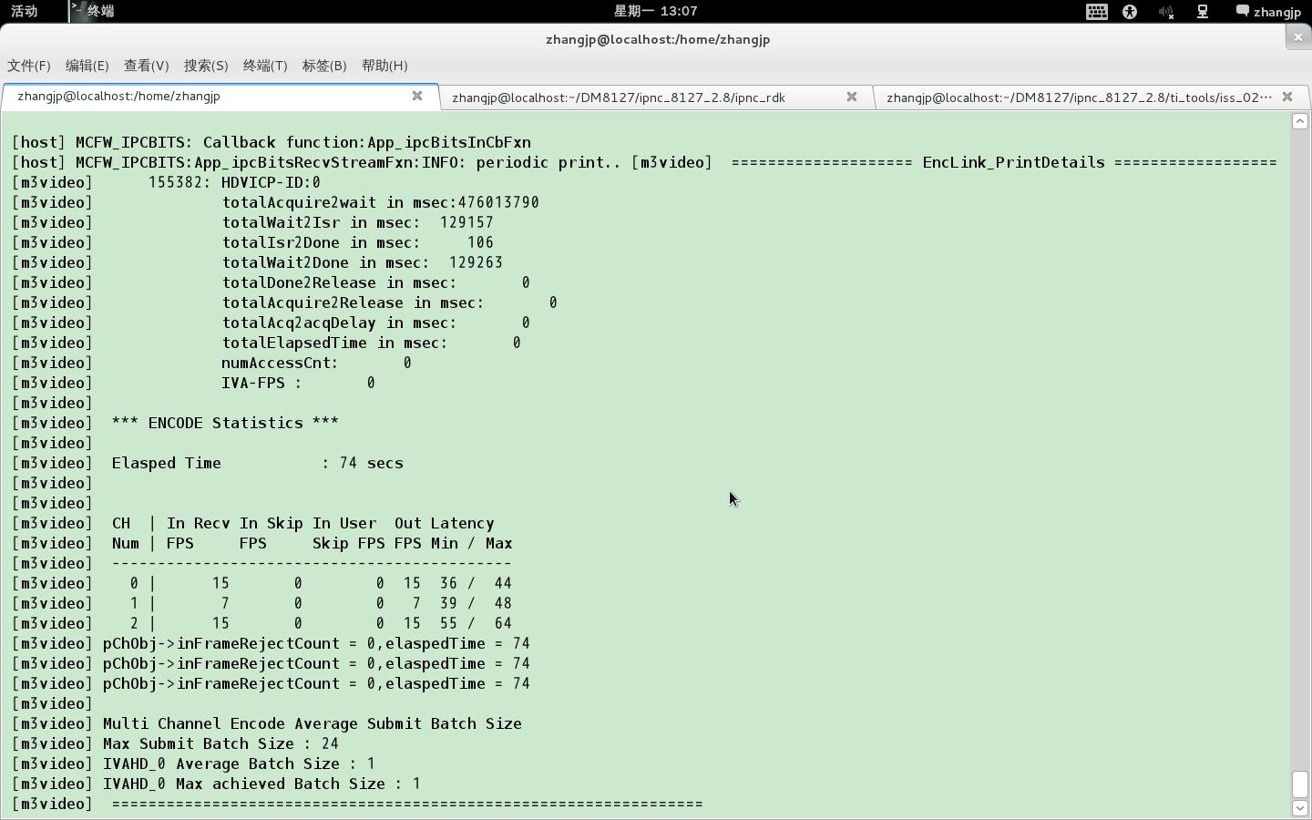

  • Thanks for your reply.
    And we modify the frame rate of sensor to output 15fps in 5M output mode. we can got 5M h.264, Mjpeg and D1 H.264, But the D1 fps is half. just like this.
    And why the D1 have half frame rata?

  • The D1 frame rate is halved in the camera link, by default we output 60fps for 1080P and 30fps for D1. If you are using the 2.8 RDK then there's an API on the camera link to change the output frame rate. If you are using an old version then you have to look into the camera link source code and modify it by yourself.
    Now, it looks like you already get 15fps for 5M H264 + MJPEG, probably the IVAHD performance is good enough to cover your triple streams encoding. In this case, it's better for you to keep the current design and do not use SIMCOP.
    1) We probably will not include high megapixel resolutions in the full feature mode, because we always need 1080P for the HDMI output. And we will not use SIMCOP based MJPEG encoder while IVAHD is enough, the SIMCOP performance can be used for other advanced features.
    2) Yes it can be supported. It's easier to modify the low power use case to support high megapixel resolutions.
    3) Well, the advice is do not use SIMCOP while IVAHD is enough. Otherwise you can always refer to the RDK2.0. What else you want to know?
