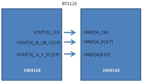

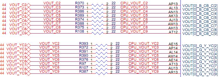

I want to use below pins as VOUT through BT1120. Can anyone help me to confirm those pins are suitable or not? Then the related registers need to set for BT1120 mode. Can anyone guide me to configure that? Thanks in advance.

Yes these pins are ok for driving BT1120 in embedded sync. clk pin is not visible here. Further for discrete sync you need to get out hsyn, vsync, fid, DE signals.
Hardik Shah
Yes, this will work but as Hardik mentioned I would also connect the H & V syncs so that you can send full range data across the link.
When using embedded syncs your data can only range from 16 thru 235.
When using discrete syncs your data can be full range 0 thru 255.
What is the actual data you are sending across the link?
BR,
Steve
Dear Steve, Hardik,
Thanks for your confirmation.
But I do not clear on this string "connect the H & V syncs so that you can send full range data across the link." Can you explain more details about the meaning of full range? Thanks in advance.
B.R.
OC
ITU1120 does not use discrete syncs so they use some of the 16 bit data codes to indicate synchronization information.
This is done by using byte channel codes 0 thru 15 and 236 thru 255 cannot be used for video information and are used to convey synchronization information.
If you use discrete syncs then the byte channels can carry data values of 0 thru 255.
BR,
Steve
