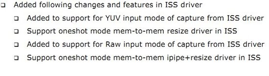

Hi all!
    About the Release_Notes_Version2.8.0.pdf, ISS driver support oneshot mode.
How can I enable camera running in the oneshot mode mem-to-mem ipipe+resize ?
Anybody give us some advice?

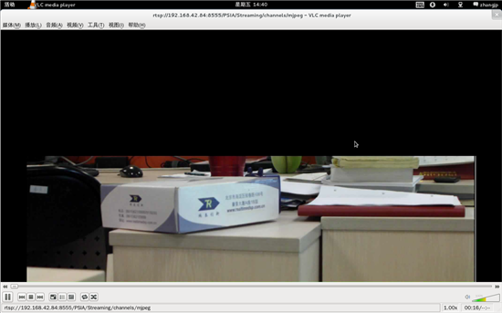

  •  Hi all
    The camera runs m2m mode and outputs H264(1080p)+D1+MJPEG(1080p),
    when we set RAW data getted from IspLink_drvProcessFrames() funcion to 0.
    But the mjpeg stream is not what  we wished.
    The modified code are as follows:
    Int32 IspLink_drvProcessFrames(IspLink_Obj * pObj)
      #if 1 //add
          int Inwidth = 0;
          int InHeigt= 0;
          int size = 0;
          char *inAddr = NULL;
          Inwidth = rszCfg.inWidth ;  //rszCfg.inWidth is 1920
          InHeigt = rszCfg.inHeight ;  //rszCfg.inHeight is 1080
          size = Inwidth*InHeigt;
          inAddr = (char *)pDrvObj->processList.inFrameList[0]->frames[0]->addr[0][0];
          memset(inAddr,val,size);
      #endif //end add
        /* Process the frames */
         status = FVID2_processFrames(pDrvObj->fvidHandle, &pDrvObj->processList);
         UTILS_assert(status == FVID2_SOK);
    The camera output MJPEG stream is as follow:
    The half of the screen is dark.We have memset bufsize(1920*1080)  to 0 ,why is not all of the screen drak?
  • What is the functionality you are trying to achive?
    I suspect that the FILL operation is not working on all buffers. Can you please add details on what needs to be done and what changes you have made?
    Rajat

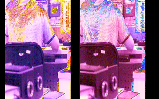

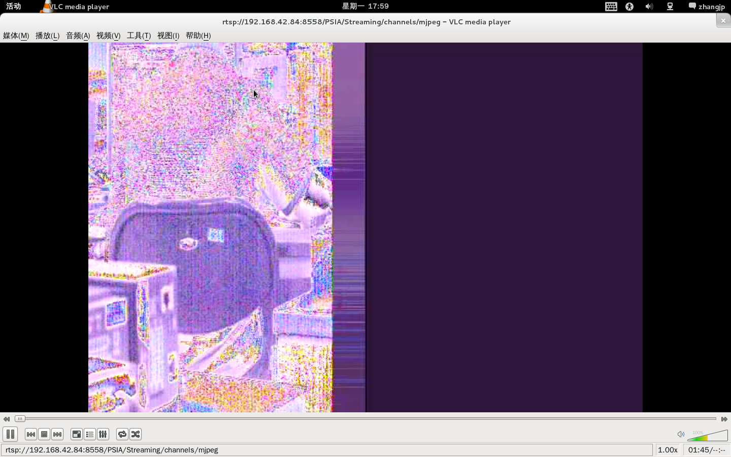

  • Thank for  .
    We change the iss registers value to capture RAW8.The modified code are as follows:
    1、
    ISP_RETURN IssIsifParamsInitPreview(....)
    #if 0 //raw16
        default_preview_sdram_op_params.dpcm_enable = ISIF_DPCM_ENCODER_ENABLE_OFF;
        #ifdef SENSOR_12BIT
             default_preview_sdram_op_params.sdram_pack_fmt = ISIF_SDRAM_PACK_12BITS;
        #else
            default_preview_sdram_op_params.sdram_pack_fmt = ISIF_SDRAM_PACK_16BITS;
        #endif
        default_preview_sdram_op_params.memory_addr_offset = sizes->ppln * 2;
       #ifdef USE_PARALLEL_VIDEO_PORT
           default_preview_sdram_op_params.ccd_raw_shift_value = ISIF_CCD_DATA_NO_SHIFT;
       #endif
    #else //raw8
        default_preview_sdram_op_params.sdram_pack_fmt = ISIF_SDRAM_PACK_8BITS;
        default_preview_sdram_op_params.memory_addr_offset = sizes->ppln;
        default_preview_sdram_op_params.ccd_raw_shift_value =ISIF_CCD_DATA_RIGHT_SHIFT_4 ;
          //ISIF_CCD_DATA_RIGHT_SHIFT_4;ISIF_CCD_DATA_NO_SHIFT
    #endif
    2、
    set ipipeif_reg->ADOFS = 0x50;
    3、
    set isif_reg->HSIZE = 0x50;
    But the output stream is as follow:
    In the isplink, before RAW->yuv,the RAW buffer data size is width*height, but the buffer data is not right.
    The output stream is as before.
     Where should we must modify also to capture RAW8?
    Can you give us more advices?
