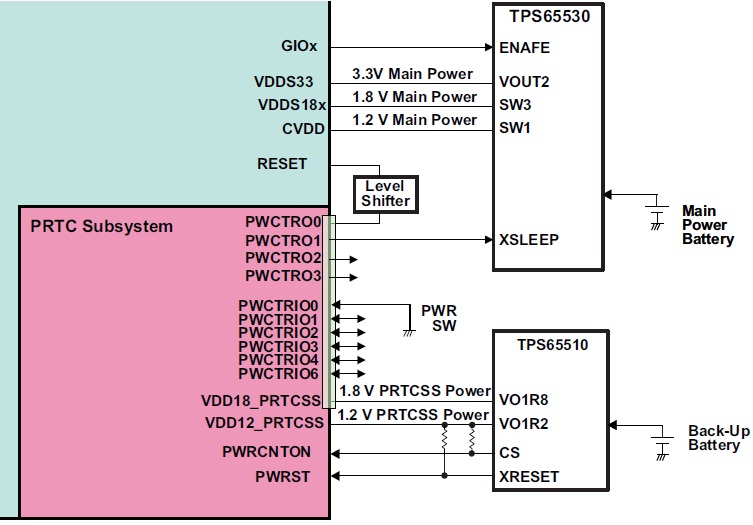

We have queries regarding the PRTCSS and TPS65510
  1. When main battery is not there, TPS65510 will be on backup battery and only 1.2V rail is powered, it means PWCTRO0 is driven low (which powered from 1.8V of TPS65510) and PRTCSS and DM368 get reset (losses it contents).
  2. In DM368 EVM , PRTCSS is in reset (PWRST 0, PWRCNTON1) according  to  SW23 configuration, it means they are not using PRTCSS
Is there any mistake in my understanding?
Kindly clarify.
