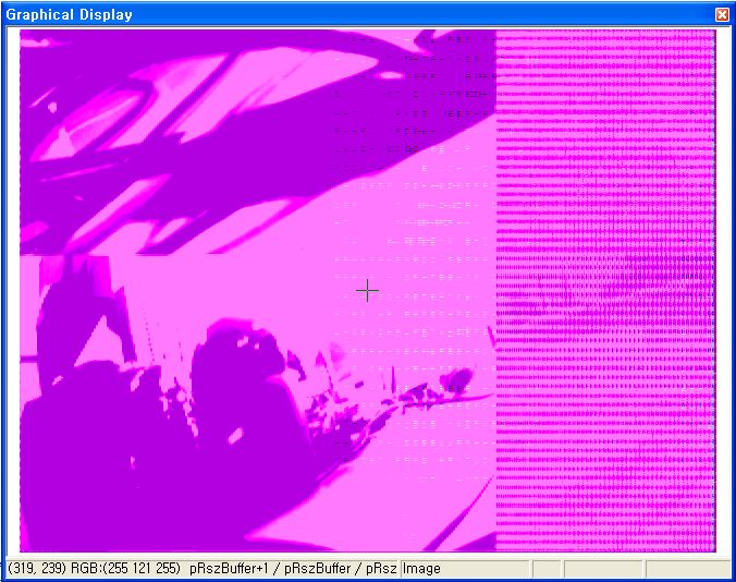

I am making a software using video_loopback as basis 10-bit raw RGB with the CMOS sensor OV2715 (using 1080P(1920x1080) configuration).
I am using CCS 3.3, XDS510 Emulator, DVSDK_1_11_00_00, and PSPDriver_1_10_00_00 on DM6437.

Someone have an idea what I’ m doing wrong?
Thanks!

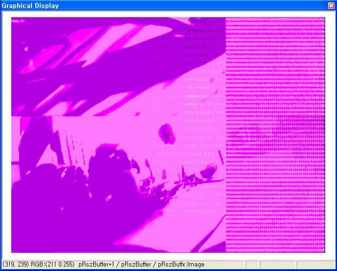

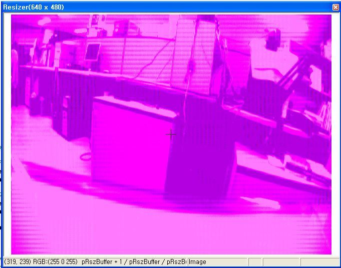

     I have caching the Raw image, but the image is worng.
    My images are as follows:
    Which part did wrong?
    Cyberkjs
    ps: my e-mail is cyberkjs@hitron.co.kr, cyberkjs@dreamwiz.com

    Cyberkjs
    I saw another way to try.
    A. Change to the size was 960x1080 to downsamplerate.
         PrevParams->downSampleRate = PSP_PREVIEWER_DOWN_SAMPLE_RATE2;
    B. Previewer of the output images were stored on DDR2.
    A result of the Resizer (960x1080-> 640x480) is shown below.
    Still come out the wrong color and the vertical black line appears in the phenomenon.
    I'm sure you do not know wrong from any part. Of you that you have someone you know about this problem, anyone wish you will reply.
