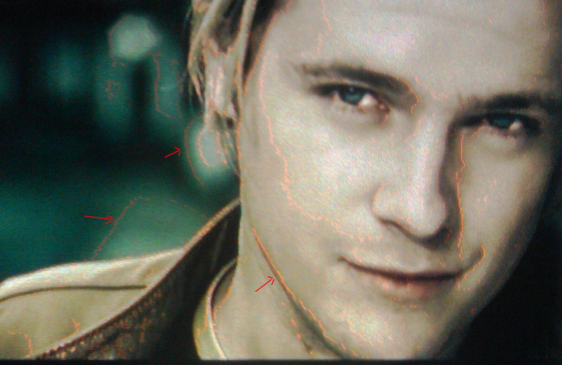

Hi,All
OS:WINCE 6.0
LCD:800×600
BSP:A8_01_01_00
Processor:DM3730
The LCD I use is 800×600,I work on DM3730. These is a problem on my LCD.
what is the reason?What is this phenomenon?
It seems to be skew between clock and data lines. Invert the clock polarity and try. Else you might have to go for eye diagram and make sure that there is no skew between clock and data.
