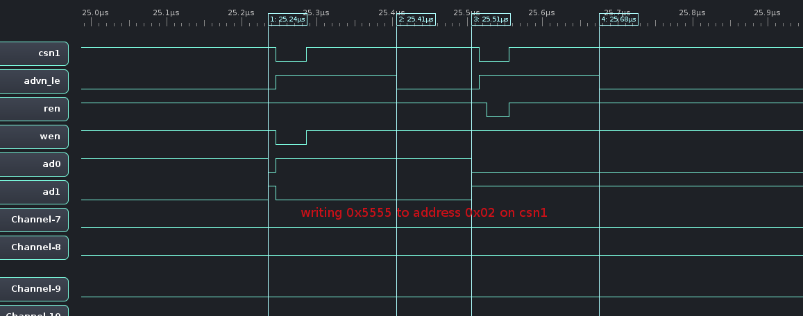

  • I did a quick capture of GPMC signal with example configuration (attached). in single access mode, the writing/reading speed i close to 12MB/s. This should be able to achieve much better speed with improved parameters.
  • Looks pretty good! I couldn't get mine that fast, but my wiring isn't optimized for high speed.

  • I finally got a kernel space driver working and everything work well. The only disapointing thing is the read speed ... When writing i get up to 22MB/s but reading only gives 6MB/s. I gave a look using a logic analyzer and it seems that two subsequent reads are much more spaced when reading . I don't understand why but i'll try to sort this out.
