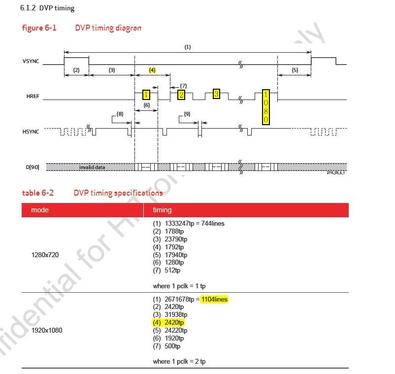

I can not do in the RAW RGB(10-bit) image with DM6437.
I am try to get 720p raw image from the OV2715 (1080P, 720P support) sensor.
I am use 10-bit rgb raw, 720p, 30fps, and 40Mhz pixel clock in OV2715.
I use the video timing is illustrated in the following

  B) CCDC settings.
      ccdcParams->inpmod = FVID_CCDC_RAW_FORMAT;
      ccdcParams->ffMode = FVID_FRAME_MODE;
      ccdcParams->height = 720;
      ccdcParams->width = 1280;
      ccdcParams->pitch = 2560; // (1280*2);
      ccdcParams->horzStartPix = 0;
      ccdcParams->vertStartPix = 13;
      ccdcParams->appCallback = NULL;
      ccdcParams->segId = 0;
      ccdcParams->rawParams.dataSize = PSP_VPFE_BITS10;
      ccdcParams->rawParams.pack8 = PSP_VPFE_PACK8_16BITS_PIXEL;
      ccdcParams->rawParams.dataPol = PSP_VPFE_DataPol_Normal;
      ccdcParams->rawParams.VDSyncPol = PSP_VPFE_SyncPol_Positive;
      ccdcParams->rawParams.HDSyncPol = PSP_VPFE_SyncPol_Positive;
      ccdcParams->rawParams.HDVDMaster = PSP_VPFE_SyncDir_Input;
      ccdcParams->rawParams.HDSyncWidth = 1;
      ccdcParams->rawParams.VDSyncWidth = 2; //(1 Line)
      ccdcParams->rawParams.numPxlPerLine = 1792;
      ccdcParams->rawParams.numLinPerFld = 774;
      ccdcParams->rawParams.ALawEnable = PSP_VPFE_ALaw_Disable;
      ccdcParams->rawParams.ALaw_Width = PSP_VPFE_ALaw_bits15_6;
      ccdcParams->extVDFxn = NULL;
