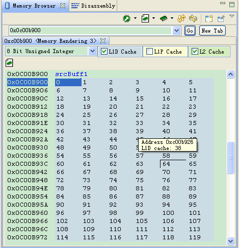

1,the first example is the pingpong.the project set the srcBuff1[0-255] = 0-255 and srcBuff2[0-255] = 0-255 .when the EDMA has complete
         the transfer the detbuff1[0-255] and dstBuff2[0-255] shoule be 0-255.am I right?

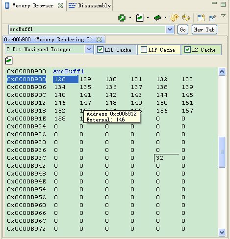

after the initialization of buffer,the memory Browser for the srcBuff1 is like this.

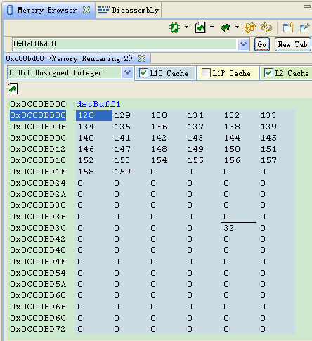

2.but when i set a breakpoint  after the completation of EDMA transfer.the dstBuff1 is like this.
why the dstBuffer1 does not  equal to srcBuff1?

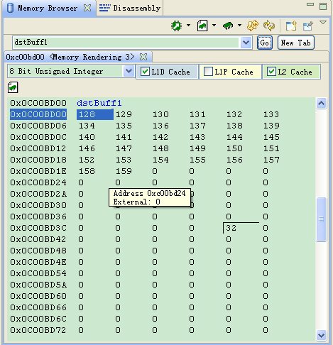

 so I look into the function Verify_Transfer(); I found when  code
    key = _disable_interrupts();
    CACHE_invL1d ((void *)srcBuff, 512, CACHE_WAIT);
    CACHE_invL2 ((void *)srcBuff, 512, CACHE_WAIT);
    CACHE_invL1d ((void *)dstBuff, 512, CACHE_WAIT);
    CACHE_invL2 ((void *)dstBuff, 512, CACHE_WAIT);
    _mfence();
    /* Re-enable Interrupts. */
    _restore_interrupts(key);
have been implement,the srcBuff1 and dstBuff1 will be like this
what this code used for?why the  block in the L1D Cache and L2 should be invalidate?thanks.
