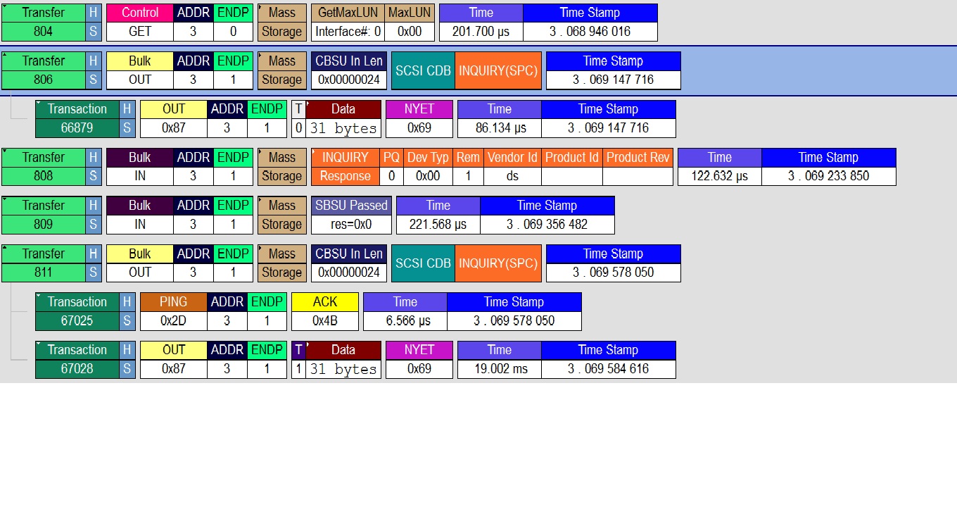

I use the 5535 as msd. EP1 for in and out.
EP0 works fine, the enumaration is done.
Now follows the INQUIRY request (31 Bytes) the first time the Count0 register shows me the 0x1F (31)
I receive the data and send the answer (36 Byte) + (13 Byte csw) that works.
Now the Windows driver repeated the same commando.
But the second time its 0x1D (29) // COUNT0 and RXCOUNT is 0x1D, on analyzer I see that the usb send 31 bytes.
What can be my problem???

The data in analyser:
