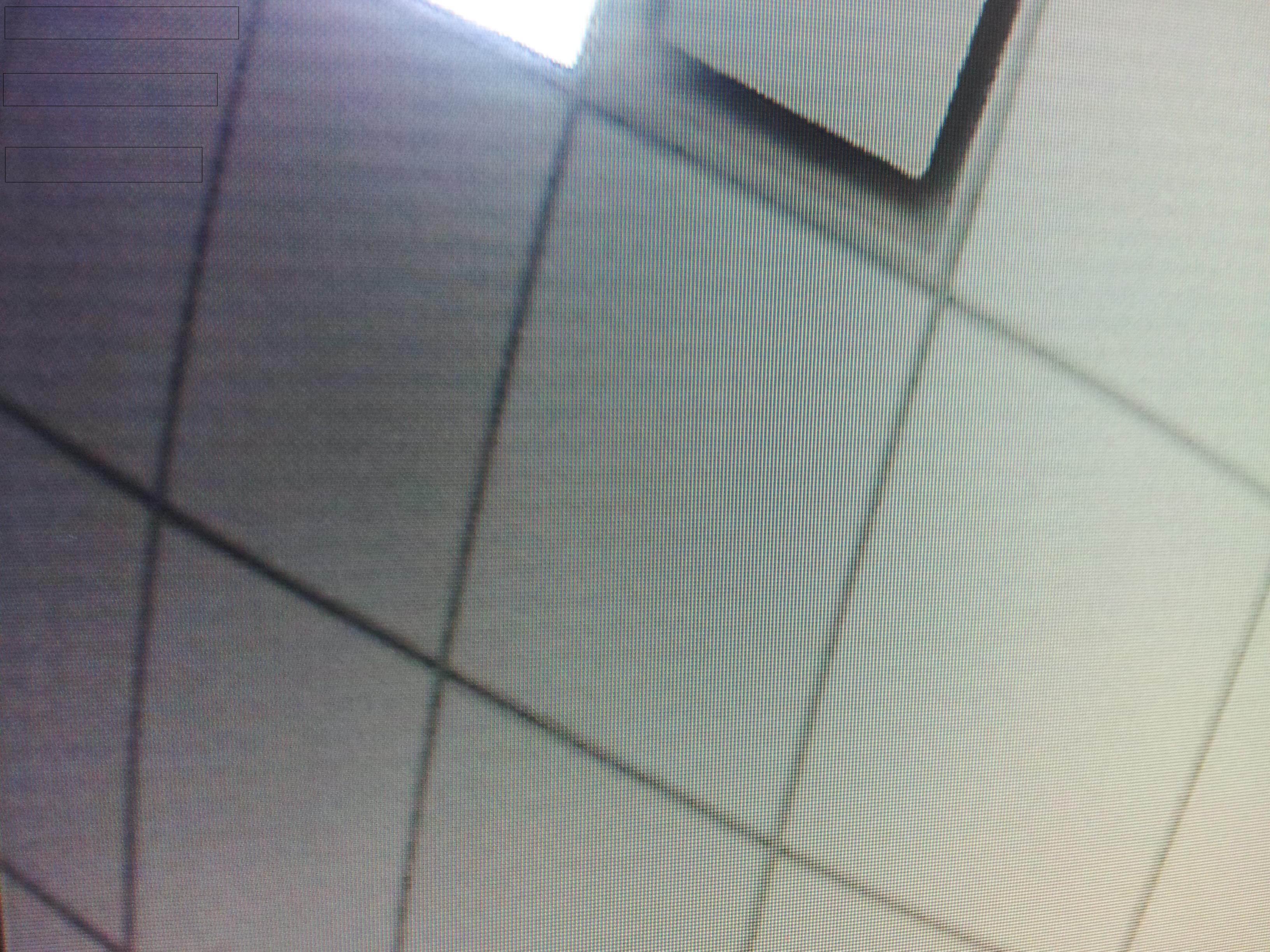

Horizontal Noise lines with Analog Video Output, Continuous Mode only at 2M capture mode
we are using Dm368 based camera and using resizer 2 for analog video output.
In 2M capture mode ( 1920x1080) , Analog Video output ( 720x480) which has been taken from Resizer 2.
This problem happens only at continuous mode, 2Mega captrue but in Single Shot  2 Mega capture Analog video output is ok.
Resizer 2 has been configured for 32 bit Linear Interpolation for down scaling.
in the attched Image i have marked few portions of the image with rectangle boxes to highlight the error pattern.

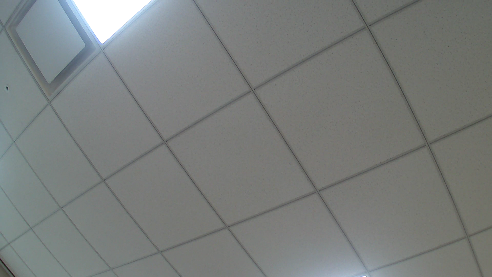

  • Attached the normal out put in 2Mega resolution 1920x1080 , just to have a compare between the normal video out put vs Analog video output in my prvius image.

    DM365 alos it works fine, and on DM368 with 3 Mega Resolution Capture ( 2048x1536 ) too it works fine.
    This problem only happens on DM368 while sensor is 2 Mega Resolution i.e Capture resolution is ( 1920x1080 ) .

    >> Resizer A output (720x480 ) in 2Mega resolution input, Continous mode(chain mode) , if i use for analog video display output then ther is no problem with the output.
    Hope you noticed my point Continious mode, as i had mentioned earlier also this problem with resizer B output happens only in Continuous mode, where as Single Shot mode it has no problem.
