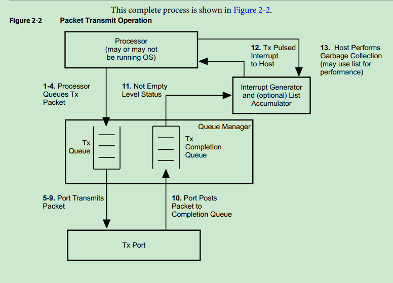

Hi everyone.Does the Tx port send the  just the packet data?Does the Tx port send descriptor too?
  • Hi Lee,
    The TX port only sends packet data and not the TX descriptor itself. When descriptors are pushed or popped from queues, only the starting address of descriptor and not the descriptor itself is moved around.
    I hope this helps.
  • HI Lee,
    Karthik's answer is correct. But to add to his answer, when the descritpor is "popped" from the tx queue the starting address of the descriptor is moved ("Pushed) to the TX completion queue.
    Depending on the PKTDMA being used the buffer data from the TX descriptor will be transferred internally into the IP (i.e. AIF, SRIO, NetCP) or immediately to another  memory location (Infrastructure PKTDMA on QMSS). The latter implies that Infrastructure PKTDMA upon processing the TX descriptor:

  • Hi Lee,
    I understand your confusion. What Karthik and I meant was that descriptor data is not moved in memory from one location to an another like the payload data. But, PKTDMA does read the TX descriptor data when it pops from the TX Q. That is the main concept of the PKT DMA. The packet may consisit of one SOP descriptor, multiple MOP descriptors and 1 EOP descriptor. Each descriptor carries control information (ex: swInfo, buffer length, flow info etc.) and payload data. They are linked together to form a packet.
    PKTDMA needs to read the descriptor data to get the payload data and control info. But, it does not move the descriptor data elsewhere in memory, it just  pops (i.e. reads the base address of the SOP) off the TXQ and pushes (writes the base address of the SOP) into the TX completion queue.

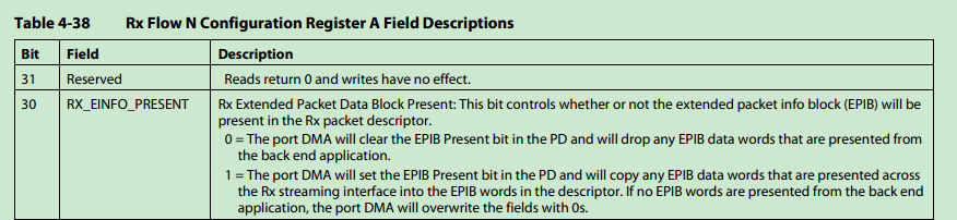

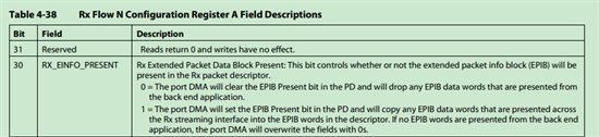

  • Hi Javier.
    when I look into the Rx Flow N Configuration Register A field Descriptions,The description for bit 30(RX_EINFO_PRESENT) is "The port DMA will set the EPIB Present bit in the PD and will copy any EPIB data words that are presented across the Rx streaming interface into the EPIB words in the descriptor. If no EPIB words are presented from the back end application, the port DMA will  overwrite the fields with 0s.".Does that mean the EPIB data will be sent from Tx port to Rx port too?If the EPIB data is sent by the Tx Port with the payload data.How the Rx port can figure out which is payload data or the EPIB data?thanks
