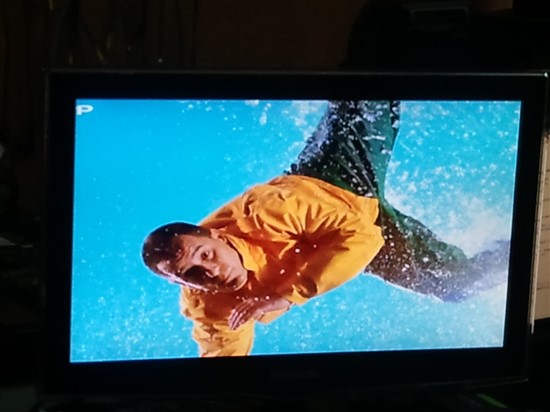

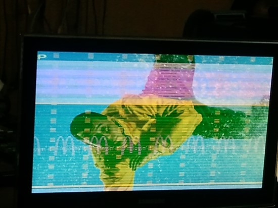

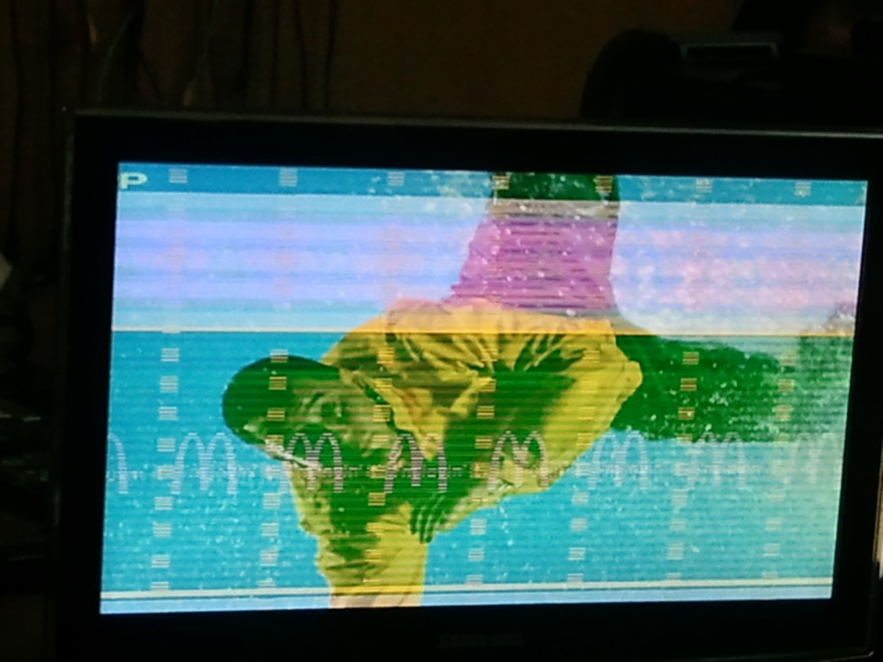

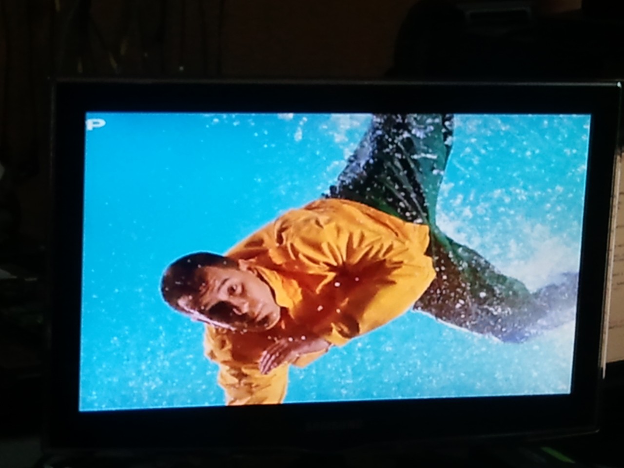

We are seeing a problem with HDMI 1080i input capture on DM8168. The capture-encode demo code present in ezsdk_5_03_01_15 has been modified to just use the capture OMX component. The captured output is showing only one field correct and the other field being garbage. We are not using DEI or any other OMX component and are trying to display the output of capture component on to HDMI display port. The images below show our output and the original output.

The output image:
Original:

    In ezsdk, for 1080i60 capture only 420sp field merged mode is supported. It will not eb able to provide two different fields or 422 format correctly. We will be providing 1080i60 support in next release.
    Vimal
