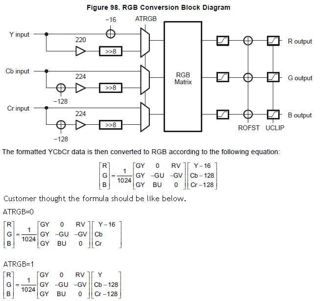

My customer thought the formula below is not matched the Figure 98. RGB Conversion Block Diagram.
Would you pls help to check if the customer's understanding is correct or there is some mistake on the table?
