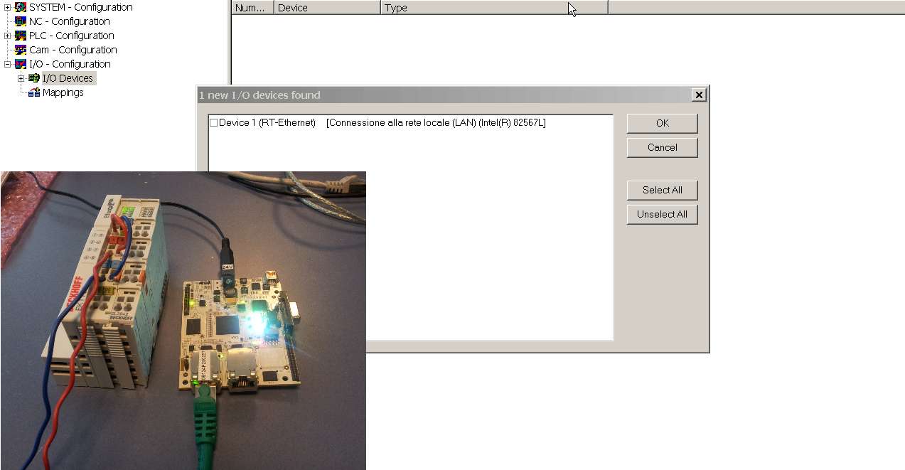

Hi, I've just bought 1 ICE board and I'm trying to follow the instructions to make it work with Twincat.
I suppose that the starting demo program (with the board just bought) is the Ethercat example.
So I tried to follow the instructions of the Getting Started Guide found in http://processors.wiki.ti.com/images/6/62/AM335x_ICE_QSG.pdf
but at the following point:
"Go to I/O – Configuration > I/O Devices – right click and select Scan Device. You will see a list of Ethernet adapters on your system, with a tick next to the adapter connected to the ICE. Choose OK. Device n (EtherCAT) will be added to I/O devices."
I cannot continue because I only see RT-Ethernet devices ,I don't see any Ethercat one and no device is added to I/O devices.
I'm quite sure that the Twincat configuration is OK because if I try a real Beckhoff slave everything works well.
Any suggestion?
Thank you very much
Luca

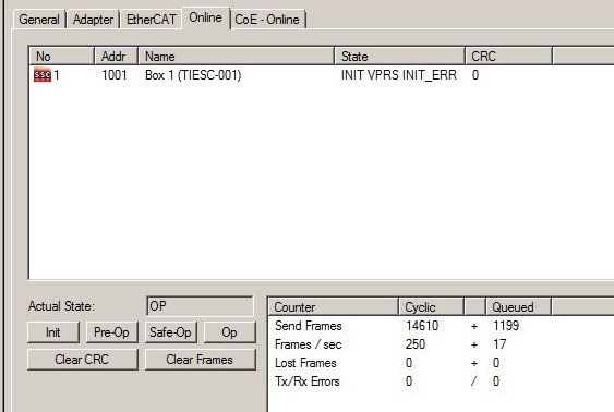

  • Hi Luca
    I have a same issue too. of course everything you metioned was checked
    But for all day long.. only 2~3 times i got correct I/O device(Box(TIESC-001)) and it's operation
    here is my screen capture.. please let me know what's going on..
  • This looks to me like a general issue with the system. Do you have another EtherCAT slave to verify that the master is correctly setup? TwinCAT requires a compatible Ethernet device in the PC in order to use it's real-time driver. You should see an 'EtherCAT' connection when scanning instead of the 'RT-Ethernet'.

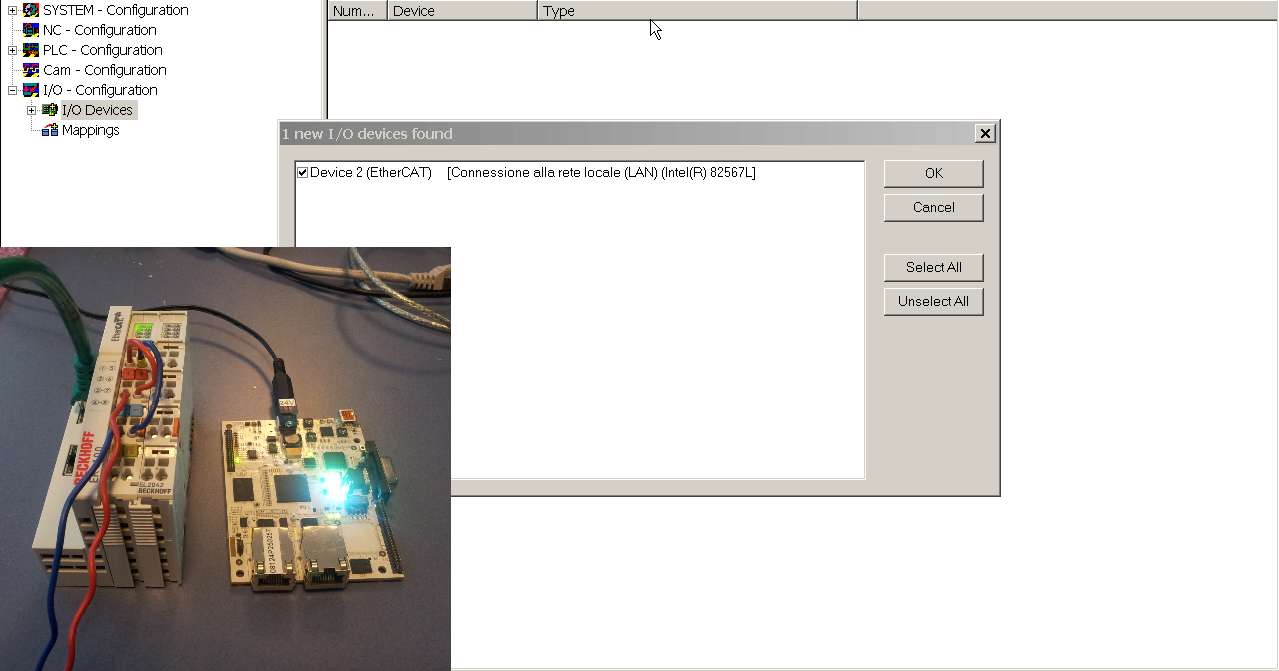

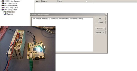

  • Yes, I have a compatible Intel Ethernet board in my laptop.
    I have a Beckhoff slave and I show you the difference between a Beckhoff slave connection (first picture) and the ICE connection (second picture).
    The configuration of master is the same in both cases and, while Twincat recognizes the Beckhoff slave with Ethercat connection, with ICE it doesn't and shows only RT-Ethernet.
    I also tried to disconnect the cable and, with cable disconnected, the behaviour is the same of the ICE connection, in fact you only see RT-Ethernet. It seems that ICE is not working properly for all.
    For information, leds D24-D31 are rolling so I think that the Ethercat slave firmware of ICE is running.
    Thanks a lot
    Luca
