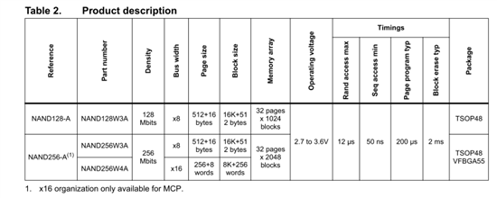

I try to boot using nandi2c method. The nand i using is NAND256W3A2BN6E, (256Mbit, 8bit) base on the nand datasheet page 7,
page size is 2^9 = 512, N=9
page per block is 16k/512 = 32, 2^5 = 32, N=5

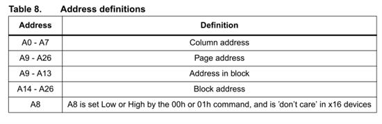

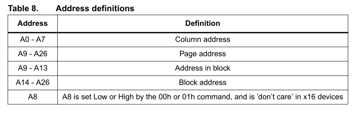

and base on the datasheet page 21:
The column address is 1 byte
the row address is 2 bytes
