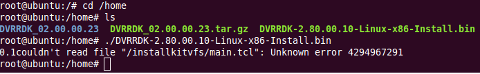

I install the DVRRDK-2.80.00.10-Linux-x86-Install.bin on ubutun 10.4,And it print
could't read “installkitvfs/main.tcl" unkown error:4294967291
How to solve this prblem?
We have validated the install binary on Ubuntu 10.4 also. It is working fine with the installation.
One potential problem i can think of is that the complete binary is not downloaded and has some missing components. Is it possible for you to try downloading again and test?
