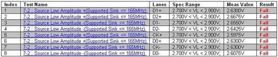

I test the eye diagram of on-chip HDMI on DM8168. Unfortunately, HDMI encounters fail in the low level range of voltage. Can anyone give some hints to pass this test?

Can you check if there is a 5.9kOhm ±1% resistor, connected from DM8168 HDMI_EXTSWING (ball AN25) to GND?
OC,
We had observed same problem on DM8148 and identied it can be managed by adding 50ohm termintors pull up to 3.3V on CLK+ and CLK- signals.
A additional SMA probe connecting on CLK pair can achieve it.
