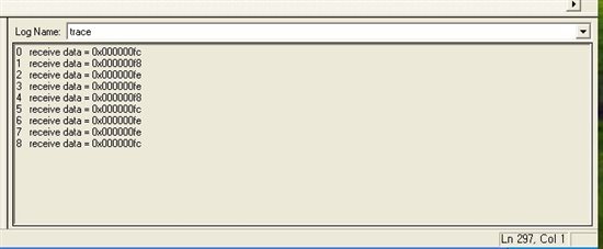

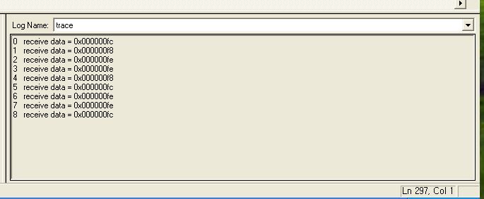

I am programming on using SPI function, the master device is DM368 chip and slave is DM6437.
I configured the SPI word length as 8bit and set CLKGDV = 1.
The master device sends the bytes from 0x01 to 0x03 by a for loop.
The received result of DM6437(slave) is correct if master's data rate 1 Mbit / Sec.
The DM6437 on the input data is strange. A byte of data is coming, but The DM368 has three bytes(0x01, 0x02, 0x3) of data output.
In addition, the data are coming in different values​​.

unsigned long SPIReceive()
     int i;
     unsigned long Recv;
     for (i=0; i<3; i++)
          // poll receiver is ready
          while(CSL_FEXT(mcbsp0ModuleRegs->SPCR, MCBSP_SPCR_RRDY)
                                   != CSL_MCBSP_SPCR_RRDY_YES);
          // read receive register
          Recv = mcbsp0ModuleRegs->DRR;
          LOG_printf(&trace, "receive data = 0x%08x ", Recv);
     return (Recv);

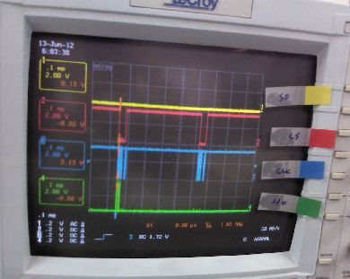

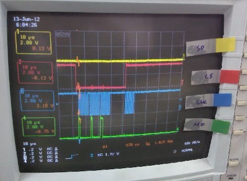

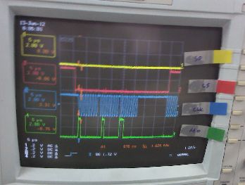

The Connection of the hardware was done as follows.
  DM365                                    DM6437
 SPI_MISO ------------- AXR0[1]/DX0/GP[104]
 SPI_SIMO ------------- AFSR0/DR0/GP[100]
 SPI_SCLK ------------ ACLKR0/CLKX0/GP[99]
 SPI_CS0  ------------- AXR0[2]/FSX0/GP[103]
The following figure the value of output from dm368 output on an oscilloscope, and that will be captured.
      Yellow - SPI_MISO
      Green  - SPI_SIMO
      Blue     - SPI_SCLK
      Red      - SPI_CS0
