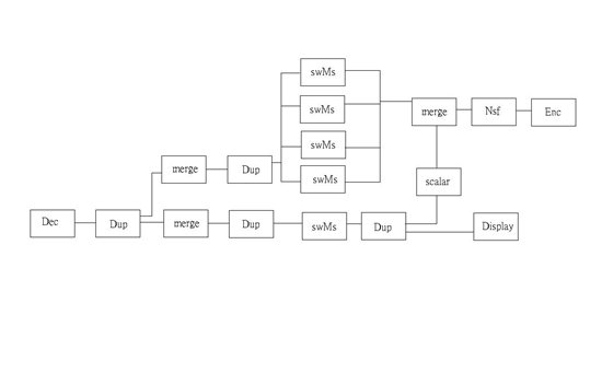

    Here  I decode  6 channels and encode 5 channels which resoution are "720p" , "704x480","704x480","512x288","640x480"
    I attached one incorrect bitstreams files for you ,"512x288"  (ths file is '*.264')
    my link flow is below :

    Your link flow diagram does not looks optimal. Could you please tell me stream/frame resolution at each stage. I dont understand the use of SwMs link at various places.
    Are you planning to merge all the channels in one plane/frame using SwMs and then encode.
  • I agree with Ritesh, I don't completely understand your setup. I'm not clear on what the Dup-merge-Dup section is doing. Do some of those have multiple channels running through them?
    And are you using the SwMS links to change the resolution of the streams?

    I decode 6 channels   which  streams' resolutions are  720p ,720p, 720p , 720x480, 720x480,720x480
    and encode 5 channels  which resolutions are  "720p" , "704x480","704x480","512x288","640x480"
    I wan to merge selected  channle in one  frame in one frame!

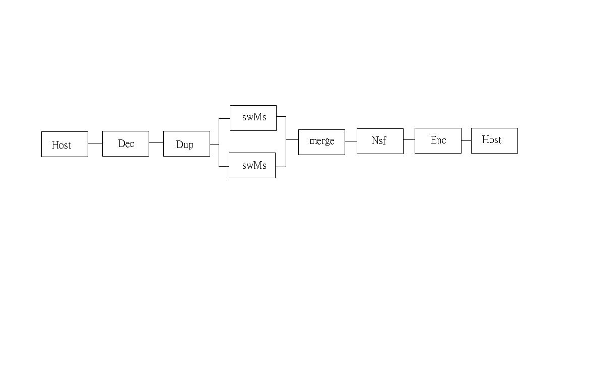

  • Hi,Brett Kuehner
    Dup-merge-Dup section will be used near the future for other purpose!
    I use the swMs to encode different resolutions !
    Actually, I also try a simple case below ,  decoding 6  channels   which resotions are 720p ,720p, 720p , 720x480, 720x480,720x480  and  encoding 2 channles which resolutions are "704x480","512x288" !  but bitstreams will be uncorrect!!

  • Steven,
    What is the intention behind using SwMs link? I am still unclear about its usage there?
  • Hi, Ritesh Rajore
    Here I use swMs link for creating different bitstreams after encoding!
    Is any other way to decide's  encoder's resolution????
    It seems that swMs decides encoder's max resolution here ,is that right ???
    thnx a lots
    best regards
  • Steven,
    You can also use VIP scalar out of DEI link that can directly give you YUV420 output. In that case you don't need NSF. For this you can use DEI in bypass mode. You can refer to HD encoder demo use case (UI option 4) where DEI link is configured in bypass mode.
    You are right, the resolution of the link that precedes encoder link decides the  max resolution of encoder. In your case it is SwMs link.
