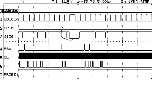

  •  You can see from this scope capture an example of what's happening when the McBSP dies.  The hardware trigger (rising edge of GPIO6) is going low sooner than it does elsewhere and there is only one response of the FSX to two rising edge hardware triggers.
    Does that help in narrowing down what would cause the crash?

    What is UB_CLK in the plot?  Also, what else is concurrently running when you see this behavior?  What bit clock are you running the McBSP at?
    Thanks.
  • Hi Ivan,
    Thanks for the inquery!
    The UB_CLK is a signal that is unrelated to the McBSP transfer.   (I see the glitch on this signal that is occuring right at the time of the failure, but I've captured this problem without this glitch present.)
    The McBSP clock rate is 17.3MHz.
    There are other DMA transfers going on besides this one.
    A collegue has pointed out that we are requesting a second McBSP transfer (low to high transition) before the first one has fully completed.  His thought is that we should never do this, and I'm inclined to agree.   Would doing this cause the McBSP function to crash?
    What makes this more complex is that the length of time it takes from the McBSP transfer hardware request to when the transfer completes varies.  My guess would be that this is probably due to multiple DMA channels using the same transfer controller.
