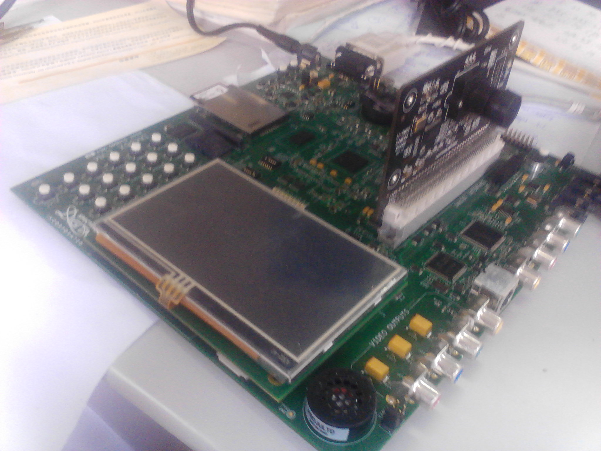

My EVEM is TMS320DM368IPNC which is bought from TI,but I donot know how to capture image from LI-5M02 Camera to display on LCD???
I have build the NFS succesfully.
Thanks in advance .

Is it IPNC or EVM platform based on DM368? There is no LCD interface available on IPNC. If you are looking for video out from IPNC platform you can connect the NTSC composite output to a TV and enable TV out(NTSC/PAL) in IPNC configuration interface available through the browser.
Are u using DVSDK 4.02 4_02_00_06? You can refer to the Software developers guide in the docs folder for demo applications for capture and display. The bootargs would need to be changed to set capture from camera.
