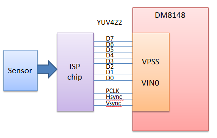

    I have one more question about my signal connection. my ISP chip just can output 8bit YUV422 via 8 bit data bus. (details please following below block diagram)
    How about this Video data (8bit YUV422), the VPSS is can support or not?
    Thank you for your help.
    Jeffrey
    This is absolutely possible. VIP can take YUV in with sync signals.
