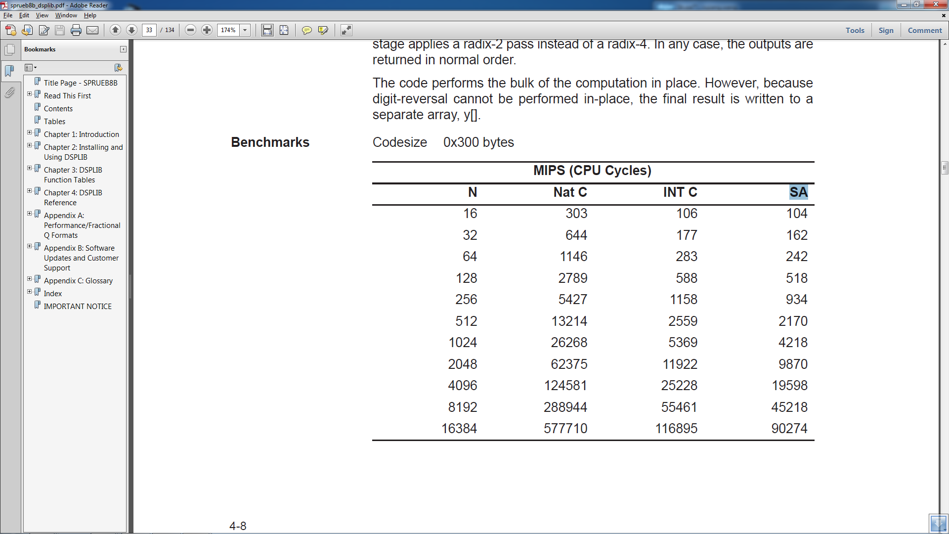

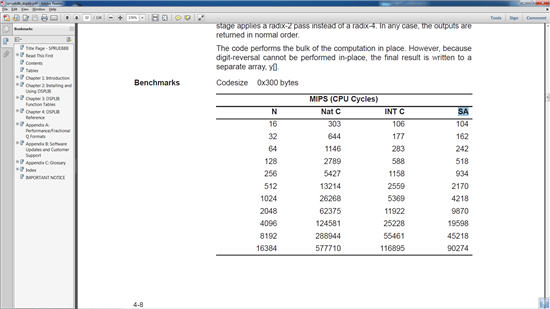

In the benchmark table, what is "SA"?
Thanks.
SA stands for 'serial assembly'. This is many a times referred to in literature as linear assembly.
You might be interested in this training slides on linear assembly code to understand the difference with assembly coding, serial assembly and highlevel C/C++ based coding on the C6000 DSP.
www.ti.com/ww/cn/uprogram/share/ppt/c6000/Chapter7.ppt
Hope this helps.
