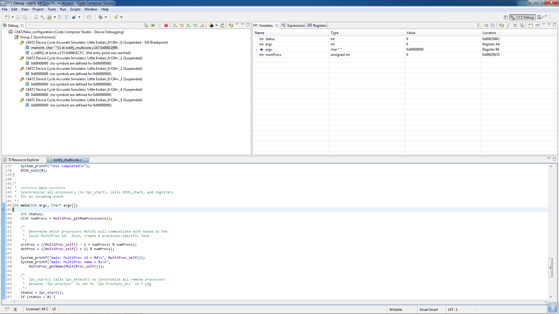

I am simulating the example Notify project on CCS v5.2, Windows 7, 64 bit. I have group and synchronize the 6 cores. When I go to the debug perspective, only core 0 shows main() and c_int0() while other cores are different. I have tried several options with no avail. Please see the picture below.
Becaues the run results are wrong, I suspect the program loading is incorrect. Thanks.

  • It seems that group and synchronose do not support loading function in simulator because it succeeds when I load the cores one by one.
    Now a new question arises. After loading, I run the cores one after one. There are messages in the control windows below. Why does it fail in the core 1 to core 2 sending message? BTW, yesterday it accidently gets the similar result (stopped at core 1 to core 2). How to dig deeper?
    Thanks.
