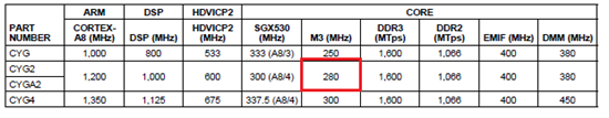

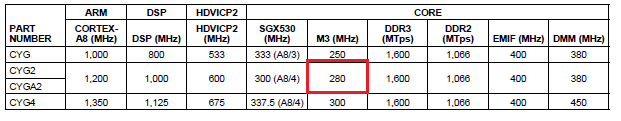

In our custom board we are using the part TMS320DM8168ACYG2(Speed Grade 2). We would like to clock the ARM Cortex A8, DSP , HDVICP2 and HDVPSS to maximum rate supported by the device as listed below :
 1)      ARM Cortex-A8 – 1.2 GHz
2)      C674x DSP – 1 GHz
3)      HDVICP2 – 600 MHz
4)      HDVPSS – 500 MHz
