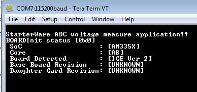

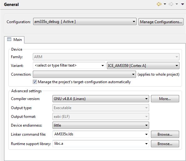

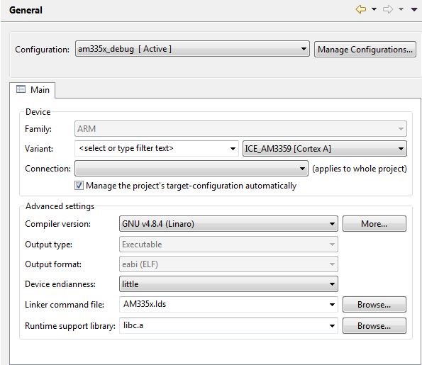

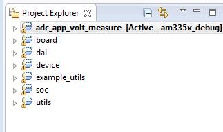

  • Rohan
    I am seeing an UART output using for the Starterware ADC example in ISDK 2.1.1.2 with CCS 6.1.1.00022
    The Build configuration for this example requires several other project to be in the environment.
    The easiest way to locate these is import from the starterware directory and select from the
    projects that are displayed.
    The adc_app... was built with the AM33x debug configuration after selecting the ICE_AM3359 board
    on the General settings Panel.
    Following the instructions on building and debugging a CCS project in the SDK getting started guide,
    the UART display immediately was visible after pressing the CCS run arrow.
    David
  • Hi David,
    Thanks for such an effort of yours, after following your procedure I could also get output till that point but nothing is getting displayed, no messages or any garbage value.  Could you get any output ?
    Thanks & Regards
    Rohan
