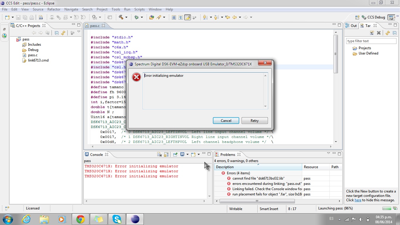

  • I am having the
    TMS320C671X: Error initializing emulator
    problem described above. I installed ccs v5.2 into my windows 7 machine and then went to help>updates, which installed a bunch of updates. I imported the post example from the DSK6713 installation.
    If I look in
    Control Panel\Hardware and Sound\Devices and Printers
    I see an unknown device that comes and goes as I plug and unplug the usb cable to my DSK6713 board. It looks like the CCSv5 installation does not install the driver.
    Any ideas?

  • Hi !!
    I´m working with TMS320C6713 DSK 16 MEG and Code composer studio V5. I have a problem at moment of debug pass the example.
    Any solution?
    Thank you Luis.
