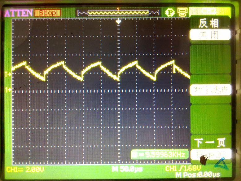

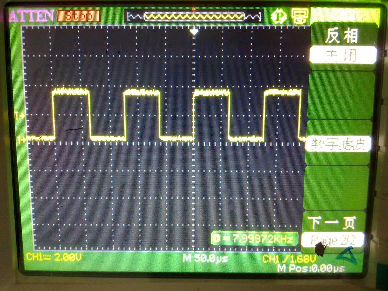

When FSR was not conneted (only FSX is connected to WCLK), i measured FSX, it is 8KHz ,the signal wave is correct as below:
when FSR is also connected (FSX and FSR are both connected to WCLK), FSX signal is becoming bad, the wave is not square as below:
FSX and FSR are both input, how FSR can interfere FSX signal? Is there any register set not connect?
