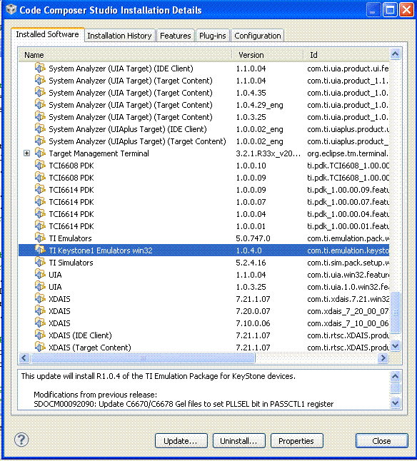

I have four EVMs here to test a four DSP setup. I have three Rev. 2A boards. I can connect to the boards and call "system reset". I also have one Rev. 3A board. If I connect to that one (and do exactly the same as with the Rev. 2A boards) and call "system reset" I see lots of error messages.
(I tries all kinds of reboot, also different PCs).
Message:
C66xx_0: Trouble Reading PC Register: (Error -1178 @ 0x5F) Device functional clock appears to be off. Power-cycle the board. If error persists, confirm configuration and/or try more reliable JTAG settings (e.g. lower TCLK). (Emulation package 5.0.569.0) C66xx_0: Trouble Reading Memory Block at 0x1840020 on Page 0 of Length 0x4: (Error -1178 @ 0x1840020) Device functional clock appears to be off. Power-cycle the board. If error persists, confirm configuration and/or try more reliable JTAG settings (e.g. lower TCLK). (Emulation package 5.0.569.0) C66xx_0: Trouble Reading Memory Block at 0x1840040 on Page 0 of Length 0x4: (Error -1178 @ 0x1840040) Device functional clock appears to be off. Power-cycle the board. If error persists, confirm configuration and/or try more reliable JTAG settings (e.g. lower TCLK). (Emulation package 5.0.569.0) C66xx_0: Trouble Reading Memory Block at 0x1840000 on Page 0 of Length 0x4: (Error -1178 @ 0x1840000) Device functional clock appears to be off. Power-cycle the board. If error persists, confirm configuration and/or try more reliable JTAG settings (e.g. lower TCLK). (Emulation package 5.0.569.0) C66xx_0: Trouble Reading Register DNUM: (Error -1178 @ 0x50) Device functional clock appears to be off. Power-cycle the board. If error persists, confirm configuration and/or try more reliable JTAG settings (e.g. lower TCLK). (Emulation package 5.0.569.0) C66xx_0: Trouble Reading Memory Block at 0x1840020 on Page 0 of Length 0x4: (Error -1178 @ 0x1840020) Device functional clock appears to be off. Power-cycle the board. If error persists, confirm configuration and/or try more reliable JTAG settings (e.g. lower TCLK). (Emulation package 5.0.569.0) C66xx_0: Trouble Reading Memory Block at 0x1840040 on Page 0 of Length 0x4: (Error -1178 @ 0x1840040) Device functional clock appears to be off. Power-cycle the board. If error persists, confirm configuration and/or try more reliable JTAG settings (e.g. lower TCLK). (Emulation package 5.0.569.0) C66xx_0: Trouble Reading Memory Block at 0x1840000 on Page 0 of Length 0x4: (Error -1178 @ 0x1840000) Device functional clock appears to be off. Power-cycle the board. If error persists, confirm configuration and/or try more reliable JTAG settings (e.g. lower TCLK). (Emulation package 5.0.569.0) C66xx_0: Trouble Reading Register DNUM: (Error -1178 @ 0x50) Device functional clock appears to be off. Power-cycle the board. If error persists, confirm configuration and/or try more reliable JTAG settings (e.g. lower TCLK). (Emulation package 5.0.569.0) C66xx_0: Trouble Reading Register CSR: (Error -1178 @ 0x41) Device functional clock appears to be off. Power-cycle the board. If error persists, confirm configuration and/or try more reliable JTAG settings (e.g. lower TCLK). (Emulation package 5.0.569.0)
I also tried a 500 KHz JTAG frequency with the same result. Maybe CCS is not the very latest version. 5.1.1.000031
Is anything known one has to change when running a Rev. 3A (instead of a Rev. 2A) board ?
