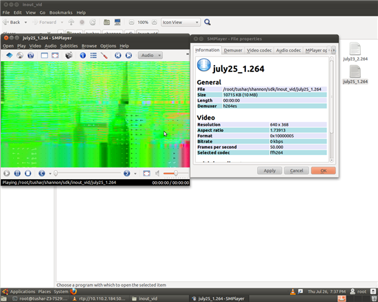

  • Hi Paula,
      I had tried to make changes in params->maxHeight,  params->maxWidth but i got output distorted i.e there was no change in resolution but only some part of video was some what clear.
     I think i dint understand were to make changes in order to set encoded video resolution to cif.
    Tushar

    This file was modified for 640x360 @25 GOP=12. Also if you are going to test clips which FPS are higher than 30 please modify
    params->maxFrameRate = 30000; to params->maxFrameRate = 60000;
    Paula

  • Tushar, your previous post was deleted, I think due to size of your attachment, but any case below some few sanity test question
    it is original (no modified) SV04 working ok for HD resolutions (720 or 1080)? is the output correct? If not, it is your YUV input 420 planar (YYYYUUVV)?
    On the other hand the file that I shared with you was an example for 640x360 so you would need to modify your client.c for CIF resolution (in case you haven't done it yet). Please confirm it and if possible share your modified file with me.
    thanks,
    Paula
  • Tushar, Please made another change that I was pointed out that is required.
    H264BP CIF encoding. In siuVctEncode_xdm0p9.c, function tvct_test_entry_encode_xdm0p9(), Please initialize two variables as shown below:
    XDAS_UInt32 topSliceline=0, bottomSliceline=0;
    Thanks and please let us know if this works,
    Paula

     I have tried same but whatever i got at output is the video of CIF Resolution as i have set it. But this video is not visible.
    I think we telling to encoder that the video (Input provided to encoder) has CIF resolution, and encoder encode this video considering this as CIF YUV input so that we are getting Distorted output video.(I have attached screen shot of my desktop)
      I think that as suggested it is better to impliment TSU in sv04 demo for resizing. So please tell what way should i do it.

  • Hi Tushar, Apologize if I was not clear, the changes that I sent was for showing how to modify the encoder configuration parameters, but the encoder does not any resizing, resizing has to be done before. You can resize your image with a computer tool in order to test the encoder or you can use TSU component as Hongmei point it out.
    Thank you,
    Paula
  • Thanks paula for your help at leat i got that i will need to change encoder parameter when i will apply CIF in input side.
